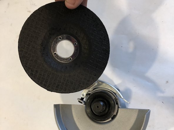

    • Remove the wrench from the detachable handle.
  2. RYOBI AG454 Blade Replacement: crwdns2935265:02crwdnd2935265:01crwdnd2935265:01crwdne2935265:0
    • Ensure that the spindle lock is engaged.
    • Remove the clamp nut from top of disc with wrench that's located inside the handle.
  3. RYOBI AG454 Blade Replacement: crwdns2935265:03crwdnd2935265:01crwdnd2935265:02crwdne2935265:0 RYOBI AG454 Blade Replacement: crwdns2935265:03crwdnd2935265:02crwdnd2935265:02crwdne2935265:0
    • Remove the grinding wheel from the device.
