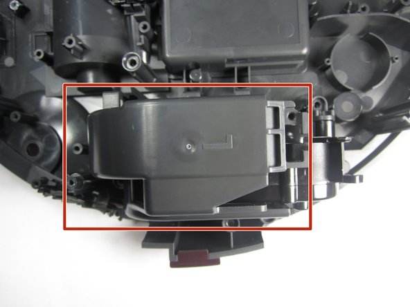

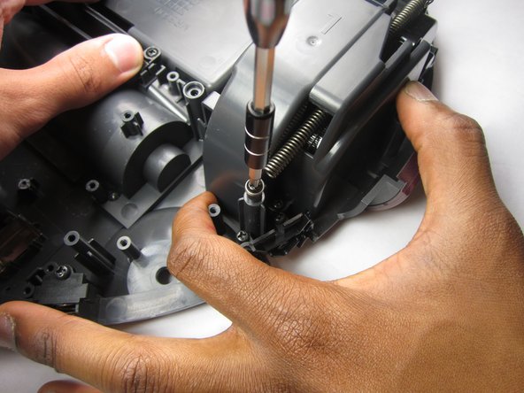

    1. RYDIS H68 Pro Wheel  Replacement, Wheel assembly: crwdns2935265:06crwdnd2935265:01crwdnd2935265:01crwdne2935265:0
      • Remove three 10mm Philips #1 screws that are securing the wheel assembly.
    2. RYDIS H68 Pro Wheel  Replacement: crwdns2935265:07crwdnd2935265:01crwdnd2935265:02crwdne2935265:0 RYDIS H68 Pro Wheel  Replacement: crwdns2935265:07crwdnd2935265:02crwdnd2935265:02crwdne2935265:0
      • Remove the 10mm Phillips #1 screw securing the spring.
      • Then undo the spring from the plastic hook to completely remove it from the wheel assembly.

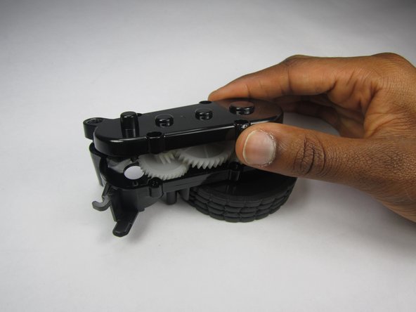

    3. RYDIS H68 Pro Wheel  Replacement: crwdns2935265:08crwdnd2935265:01crwdnd2935265:03crwdne2935265:0 RYDIS H68 Pro Wheel  Replacement: crwdns2935265:08crwdnd2935265:02crwdnd2935265:03crwdne2935265:0 RYDIS H68 Pro Wheel  Replacement: crwdns2935265:08crwdnd2935265:03crwdnd2935265:03crwdne2935265:0
      • Lift up on the plastic piece to remove the entire wheel assembly.

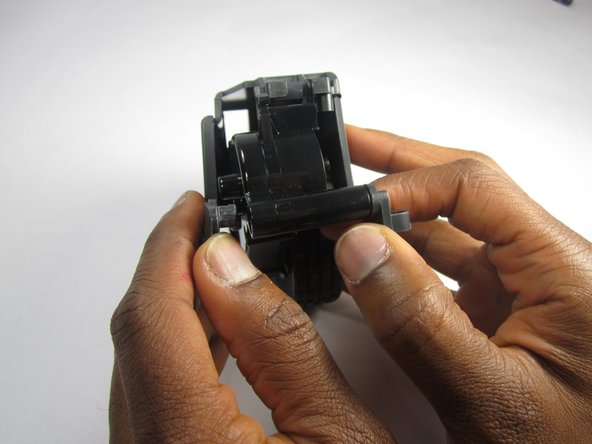

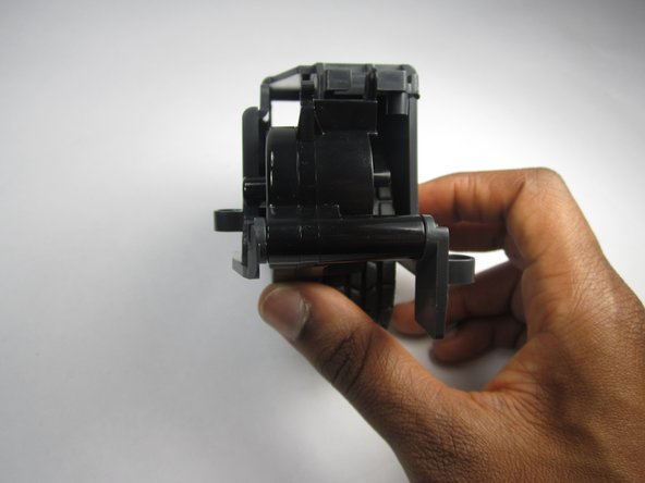

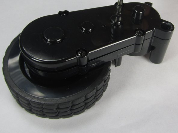

    4. RYDIS H68 Pro Wheel  Replacement: crwdns2935265:09crwdnd2935265:01crwdnd2935265:03crwdne2935265:0 RYDIS H68 Pro Wheel  Replacement: crwdns2935265:09crwdnd2935265:02crwdnd2935265:03crwdne2935265:0 RYDIS H68 Pro Wheel  Replacement: crwdns2935265:09crwdnd2935265:03crwdnd2935265:03crwdne2935265:0
      • Remove the plastic frame by pulling outward on the two spots where it is fastened.

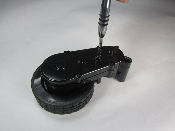

    5. RYDIS H68 Pro Wheel  Replacement: crwdns2935265:010crwdnd2935265:01crwdnd2935265:02crwdne2935265:0 RYDIS H68 Pro Wheel  Replacement: crwdns2935265:010crwdnd2935265:02crwdnd2935265:02crwdne2935265:0
      • Remove the four 10mm Phillips #1 screws around the edges of the cover.

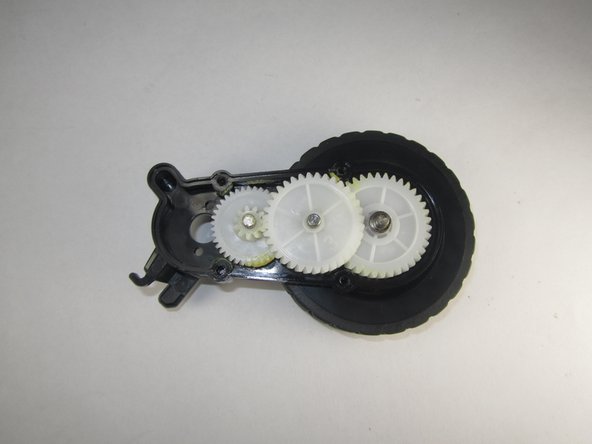

    6. RYDIS H68 Pro Wheel  Replacement: crwdns2935265:011crwdnd2935265:01crwdnd2935265:03crwdne2935265:0 RYDIS H68 Pro Wheel  Replacement: crwdns2935265:011crwdnd2935265:02crwdnd2935265:03crwdne2935265:0 RYDIS H68 Pro Wheel  Replacement: crwdns2935265:011crwdnd2935265:03crwdnd2935265:03crwdne2935265:0
      • Lift up on the top cover to remove it.
      • Removing the top cover reveals the gear system consisting of three gears.
