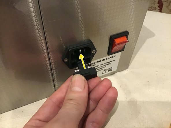

  1. ROVSUN Ultrasonic Cleaner Fuse Replacement, Removing fuse insert: crwdns2935265:01crwdnd2935265:01crwdnd2935265:02crwdne2935265:0 ROVSUN Ultrasonic Cleaner Fuse Replacement, Removing fuse insert: crwdns2935265:01crwdnd2935265:02crwdnd2935265:02crwdne2935265:0
    • Switch device off (0) and unplug the power cord before starting
    • Insert flathead screwdriver to push out the fuse insert
    • Completely remove fuse insert
  2. ROVSUN Ultrasonic Cleaner Fuse Replacement, Removing fuse from insert: crwdns2935265:02crwdnd2935265:01crwdnd2935265:02crwdne2935265:0 ROVSUN Ultrasonic Cleaner Fuse Replacement, Removing fuse from insert: crwdns2935265:02crwdnd2935265:02crwdnd2935265:02crwdne2935265:0
    • Flip fuse insert over to gain access to the fuse
    • Pull fuse out of bracket
    • Use screwdriver to push out sparefuse
  3. ROVSUN Ultrasonic Cleaner Fuse Replacement, Replacing fuse: crwdns2935265:03crwdnd2935265:01crwdnd2935265:02crwdne2935265:0 ROVSUN Ultrasonic Cleaner Fuse Replacement, Replacing fuse: crwdns2935265:03crwdnd2935265:02crwdnd2935265:02crwdne2935265:0
    • Insert spare fuse into bracket
    • Position fuse insert with guide bar on top
    • Insert fuse bracket into AC module and push it all the way in.
Plug in power cord and switch power on (1)
