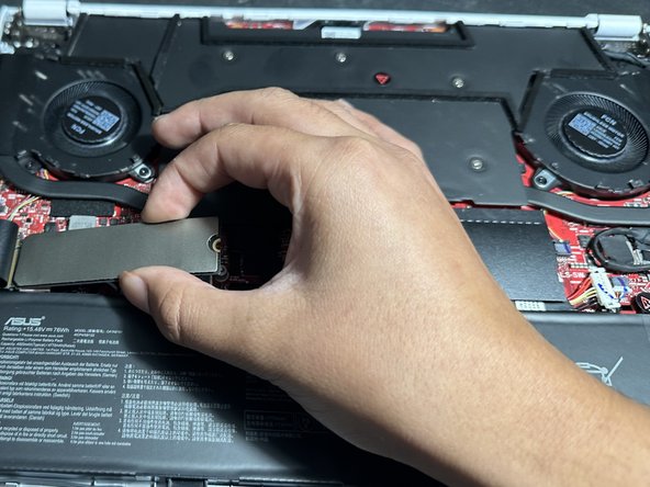

  4. ROG Zephyrus G14 SSD and RAM Replacement, SSD Replacement: crwdns2935265:04crwdnd2935265:01crwdnd2935265:02crwdne2935265:0 ROG Zephyrus G14 SSD and RAM Replacement, SSD Replacement: crwdns2935265:04crwdnd2935265:02crwdnd2935265:02crwdne2935265:0
    • To replace the storage, locate the M.2 SSD under the longer black strip on the left.
    • Remove the screw holding it down. Proceed to pull the SSD out towards the outside of the chassis.
    • Slide the new SSD in making note of the keying as it may only be inserted one way (similar to RAM). You should be inserting it at a roughly 30-45 degree angle.
    • The G14 uses an M key slot. B-Key drives are unsupported. SATA drives (B + M) may work, but aren't recommended
    • Re-insert the screw to hold to new SSD in place.
