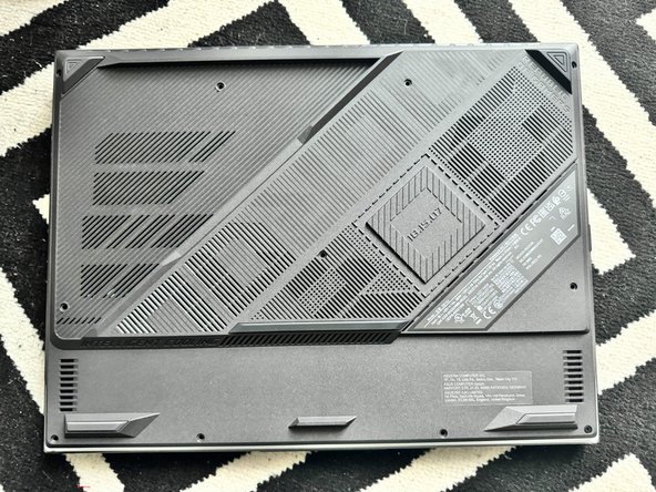

  1. ROG Strix G16 (G614J) M.2 SSD Replacement, Remote the Backplate Screws: crwdns2935265:01crwdnd2935265:01crwdnd2935265:02crwdne2935265:0 ROG Strix G16 (G614J) M.2 SSD Replacement, Remote the Backplate Screws: crwdns2935265:01crwdnd2935265:02crwdnd2935265:02crwdne2935265:0
    • Remove the following screws
    • PH0 Screws
    • This one remains captive to the backplate and will not come off.
    • These ones are also PH0 but are longer then the other ones.

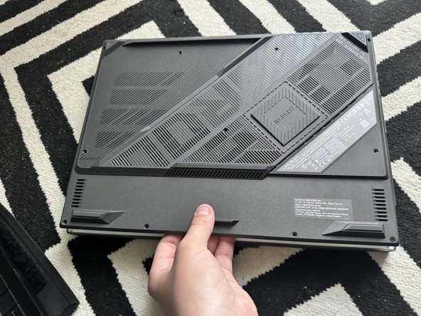

  2. ROG Strix G16 (G614J) M.2 SSD Replacement, Opening: crwdns2935265:02crwdnd2935265:01crwdnd2935265:02crwdne2935265:0 ROG Strix G16 (G614J) M.2 SSD Replacement, Opening: crwdns2935265:02crwdnd2935265:02crwdnd2935265:02crwdne2935265:0
    • Slide an Opening Pick around the edge until you make an opening
    • Carfully lift the backplate with your hand

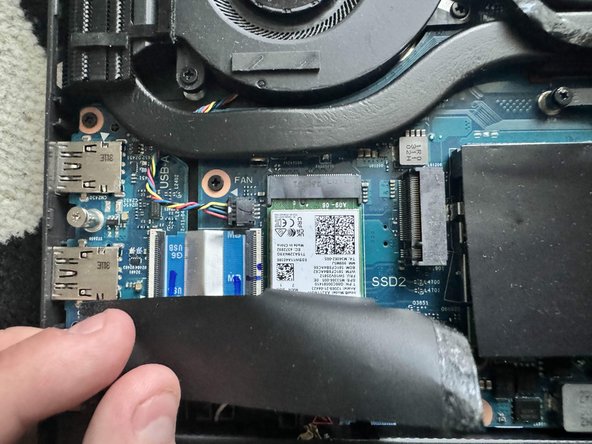

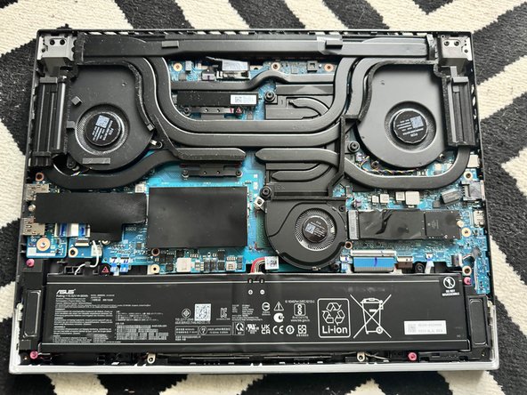

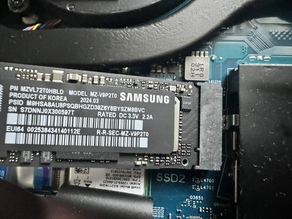

  3. ROG Strix G16 (G614J) M.2 SSD Replacement, Locating Slots: crwdns2935265:03crwdnd2935265:01crwdnd2935265:01crwdne2935265:0
    • There are 2 slots labeled "SSD1" and "SSD2"
    • The SSD1 slot has a preinstalled SSD by the OEM and has your operating system on it
    • The SSD2 slot is free and you can install a M-Key M.2
  4. ROG Strix G16 (G614J) M.2 SSD Replacement, Removing tape: crwdns2935265:04crwdnd2935265:01crwdnd2935265:02crwdne2935265:0 ROG Strix G16 (G614J) M.2 SSD Replacement, Removing tape: crwdns2935265:04crwdnd2935265:02crwdnd2935265:02crwdne2935265:0
    • Lift/Remove the tape to reveal the slot
    • You may decide if you would like to keep the tape, we will be reapplying it in step 9

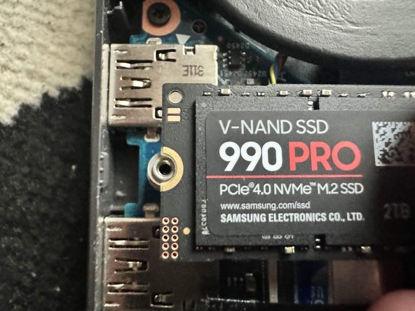

  6. ROG Strix G16 (G614J) M.2 SSD Replacement, Inserting the M.2: crwdns2935265:06crwdnd2935265:01crwdnd2935265:03crwdne2935265:0 ROG Strix G16 (G614J) M.2 SSD Replacement, Inserting the M.2: crwdns2935265:06crwdnd2935265:02crwdnd2935265:03crwdne2935265:0 ROG Strix G16 (G614J) M.2 SSD Replacement, Inserting the M.2: crwdns2935265:06crwdnd2935265:03crwdnd2935265:03crwdne2935265:0
    • Carfully slide in the M.2 into the slot
    • Make sure to align the pins properly to avoid damaging them
    • Make sure you are installing a M-Key (5pin) M.2, A B-Key or a B&M-Key is not supported

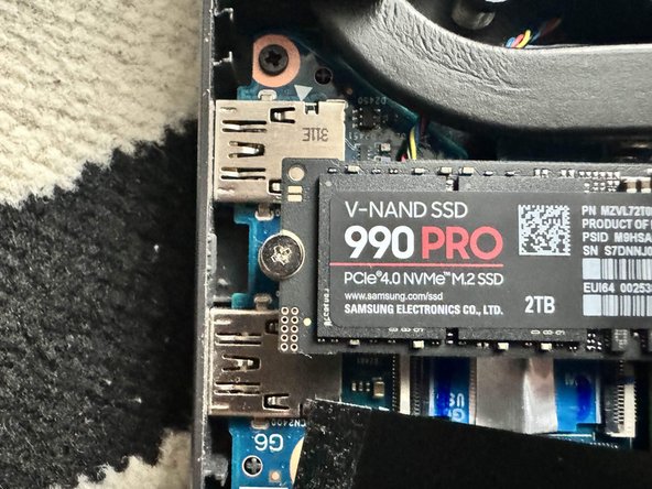

  7. ROG Strix G16 (G614J) M.2 SSD Replacement, Screwing In 1/2: crwdns2935265:07crwdnd2935265:01crwdnd2935265:02crwdne2935265:0 ROG Strix G16 (G614J) M.2 SSD Replacement, Screwing In 1/2: crwdns2935265:07crwdnd2935265:02crwdnd2935265:02crwdne2935265:0
    • Press down on the M.2

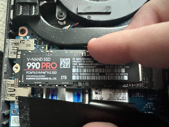

  8. ROG Strix G16 (G614J) M.2 SSD Replacement, Screwing In 2/2: crwdns2935265:08crwdnd2935265:01crwdnd2935265:03crwdne2935265:0 ROG Strix G16 (G614J) M.2 SSD Replacement, Screwing In 2/2: crwdns2935265:08crwdnd2935265:02crwdnd2935265:03crwdne2935265:0 ROG Strix G16 (G614J) M.2 SSD Replacement, Screwing In 2/2: crwdns2935265:08crwdnd2935265:03crwdnd2935265:03crwdne2935265:0
    • Align the M.2 with the screwdriver hole
    • Screw in the M.2
