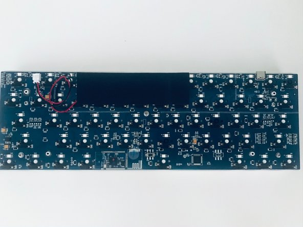

    • Carefully lift the keyboard case from the PCB (Printed Circuit Board).

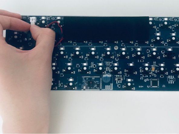

  4. RK61 Battery Replacement: crwdns2935265:04crwdnd2935265:01crwdnd2935265:03crwdne2935265:0 RK61 Battery Replacement: crwdns2935265:04crwdnd2935265:02crwdnd2935265:03crwdne2935265:0 RK61 Battery Replacement: crwdns2935265:04crwdnd2935265:03crwdnd2935265:03crwdne2935265:0
    • Unplug the old 1450 mAh lithium-ion battery by gently pinching and pulling from the right and left sides of the connector.
    • Make sure to be extremely gentle when unplugging the old lithium-ion battery from the keyboard.

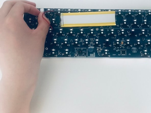

  5. RK61 Battery Replacement: crwdns2935265:05crwdnd2935265:01crwdnd2935265:03crwdne2935265:0 RK61 Battery Replacement: crwdns2935265:05crwdnd2935265:02crwdnd2935265:03crwdne2935265:0 RK61 Battery Replacement: crwdns2935265:05crwdnd2935265:03crwdnd2935265:03crwdne2935265:0
    • Plug in the new 1450 mAh lithium-ion battery by the connector.
  6. RK61 Battery Replacement: crwdns2935265:06crwdnd2935265:01crwdnd2935265:03crwdne2935265:0 RK61 Battery Replacement: crwdns2935265:06crwdnd2935265:02crwdnd2935265:03crwdne2935265:0 RK61 Battery Replacement: crwdns2935265:06crwdnd2935265:03crwdnd2935265:03crwdne2935265:0
    • Align the newly inserted 1450 mAh lithium-ion battery parallel to the edge of the PCB (Printed Circuit Board) and cover the PCB with the keyboard case.

Is it possible to replace the standard battery with a larger one with no issues other then additional weight? say a 4000 mAh which will just be longer?
shon malka - crwdns2934203:0crwdne2934203:0
There should be no issues with replacing the keyboard with a larger battery as long as the connector is the same size and the battery is small enough so that you can still cover the PCB entirely with the keyboard case.
Michelle Chen -
hey did u ever wind up doing the mod?
albert einstein -
yo. ty for the guide.
i am also interested in upgrading the battery but am unsure about:
which dimensions the new battery should be, or how to find out
if it is safe to further modify the kb with additional material through the usual mods ppl to
albert einstein - crwdns2934203:0crwdne2934203:0
should be fine to mod it to your liking
to measure simply measure the length breadth and max height u can have inside the cover and get a battery accordingly
