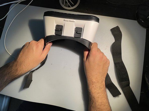

    • Place the headset right side up and facing you on a flat surface.
    • Gently detach the velcro straps from the top, left, and right sides of the headset and set them aside.
  2. RK5 PLUS VR Headset Headband Replacement: crwdns2935265:02crwdnd2935265:01crwdnd2935265:01crwdne2935265:0
    • Remove the white headband adjustment part and carefully pull it off of the three straps.

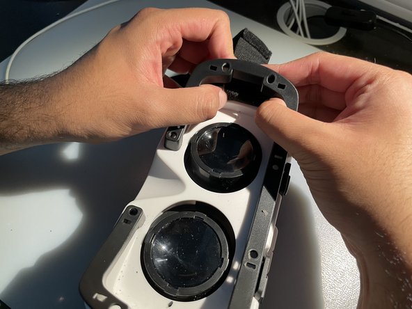

    • To access the straps that need to be replaced, remove the padding around the visual lenses of the headset.
    • To do this, use your hands to detach the plastic frame between the padding and the lenses.
    • If you need help getting started, use a spudger or opening tool and undo the clips holding the plastic frame.
    • Unhook the old straps from the sides of the headset.

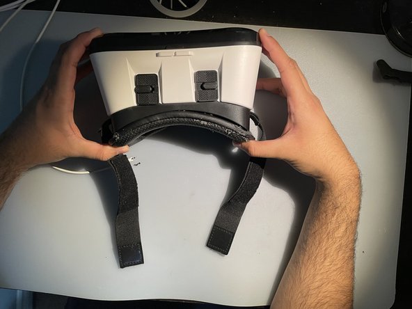

  4. RK5 PLUS VR Headset Headband Replacement: crwdns2935265:04crwdnd2935265:01crwdnd2935265:03crwdne2935265:0 RK5 PLUS VR Headset Headband Replacement: crwdns2935265:04crwdnd2935265:02crwdnd2935265:03crwdne2935265:0 RK5 PLUS VR Headset Headband Replacement: crwdns2935265:04crwdnd2935265:03crwdnd2935265:03crwdne2935265:0
    • Reattach the new velcro straps to each of the white hooks.
    • Make sure the straps are securely attached to the hooks before moving on to the next step.
  5. RK5 PLUS VR Headset Headband Replacement: crwdns2935265:05crwdnd2935265:01crwdnd2935265:02crwdne2935265:0 RK5 PLUS VR Headset Headband Replacement: crwdns2935265:05crwdnd2935265:02crwdnd2935265:02crwdne2935265:0
    • Reattach the plastic frame with the padded back onto the headset.
    • Make sure the padding is properly aligned and clicked into place.
  6. RK5 PLUS VR Headset Headband Replacement: crwdns2935265:06crwdnd2935265:01crwdnd2935265:03crwdne2935265:0 RK5 PLUS VR Headset Headband Replacement: crwdns2935265:06crwdnd2935265:02crwdnd2935265:03crwdne2935265:0 RK5 PLUS VR Headset Headband Replacement: crwdns2935265:06crwdnd2935265:03crwdnd2935265:03crwdne2935265:0
    • Reattach the top band into the top hook of the headset.
    • Take the other sides of the velcro straps and hook them into the white headband adjustment part.
    • Check that the straps are properly aligned and securely attached to the headband adjustment part.
