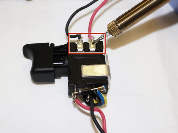

  4. RIDGID R860052 Switch Assembly Replacement: crwdns2935265:04crwdnd2935265:01crwdnd2935265:02crwdne2935265:0 RIDGID R860052 Switch Assembly Replacement: crwdns2935265:04crwdnd2935265:02crwdnd2935265:02crwdne2935265:0
    • To replace the switch assembly, desolder the black and red wires and replace with a new switch assembly.
    • Be aware of the heat level of the metal part on the soldering tool.
