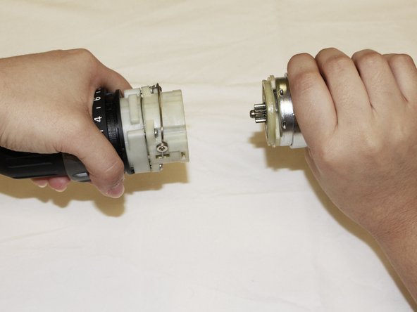

    • Remove the switch assembly, chuck, and motor from all drill covers.
  4. RIDGID R860052 Motor Replacement: crwdns2935265:04crwdnd2935265:01crwdnd2935265:02crwdne2935265:0 RIDGID R860052 Motor Replacement: crwdns2935265:04crwdnd2935265:02crwdnd2935265:02crwdne2935265:0
    • Twist the chuck and motor in the opposite direction and gently pull them apart.
  5. RIDGID R860052 Motor Replacement: crwdns2935265:05crwdnd2935265:01crwdnd2935265:03crwdne2935265:0 RIDGID R860052 Motor Replacement: crwdns2935265:05crwdnd2935265:02crwdnd2935265:03crwdne2935265:0 RIDGID R860052 Motor Replacement: crwdns2935265:05crwdnd2935265:03crwdnd2935265:03crwdne2935265:0
    • Desolder the black and red wires from the motor.
    • Replace motor and resolder the black and red wires back onto the motor.
    • Be aware of the heat level of the metal part on the soldering tool.
