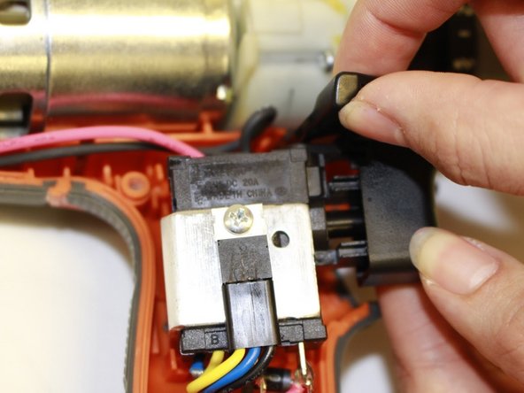

  3. RIDGID R860052 Direction of Rotation Selector Replacement: crwdns2935265:03crwdnd2935265:01crwdnd2935265:03crwdne2935265:0 RIDGID R860052 Direction of Rotation Selector Replacement: crwdns2935265:03crwdnd2935265:02crwdnd2935265:03crwdne2935265:0 RIDGID R860052 Direction of Rotation Selector Replacement: crwdns2935265:03crwdnd2935265:03crwdnd2935265:03crwdne2935265:0
    • Lift up the switch assembly.
    • Unhook the rotation selector from the drill cover and replace with a new one.
