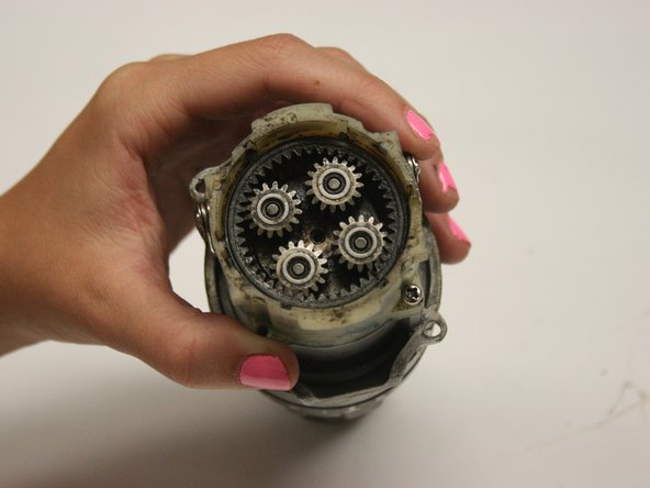

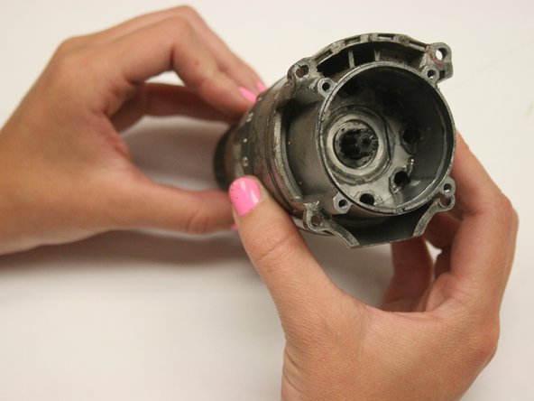

  4. RIDGID R84015 X2 Planetary Gear Replacement Guide, Planetary Gear: crwdns2935265:04crwdnd2935265:01crwdnd2935265:01crwdne2935265:0
    • Prepare to remove the gear chamber.
    • Using the Phillips #2 screwdriver, unscrew the four screws at the rear of the plastic gear chamber.
  5. RIDGID R84015 X2 Planetary Gear Replacement Guide: crwdns2935265:05crwdnd2935265:01crwdnd2935265:02crwdne2935265:0 RIDGID R84015 X2 Planetary Gear Replacement Guide: crwdns2935265:05crwdnd2935265:02crwdnd2935265:02crwdne2935265:0
    • Remove the motor from the drill by gently pulling the motor away from the gear chamber.
    • NOTE: Handle the gear chamber with caution as the gears are now loose.
  6. RIDGID R84015 X2 Planetary Gear Replacement Guide: crwdns2935265:06crwdnd2935265:01crwdnd2935265:01crwdne2935265:0
    • Remove the plastic gear chamber.
    • Using the Phillips #2 screwdriver, remove the four screws that attach the plastic gear chamber.
  7. RIDGID R84015 X2 Planetary Gear Replacement Guide: crwdns2935265:07crwdnd2935265:01crwdnd2935265:02crwdne2935265:0 RIDGID R84015 X2 Planetary Gear Replacement Guide: crwdns2935265:07crwdnd2935265:02crwdnd2935265:02crwdne2935265:0
    • Remove each component from the gear assembly. Replace components as needed.
    • Reassemble the drill following the gear replacement instructions in reverse order.
