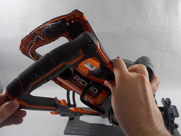

    • Using the Torque 20 screwdriver, remove the twelve 3/10 cm screws holding the handle set together.
  3. RIDGID R32104 Trigger  Replacement: crwdns2935265:03crwdnd2935265:01crwdnd2935265:02crwdne2935265:0 RIDGID R32104 Trigger  Replacement: crwdns2935265:03crwdnd2935265:02crwdnd2935265:02crwdne2935265:0
    • Carefully remove the handle set from the main housing assembly.

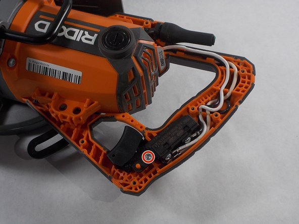

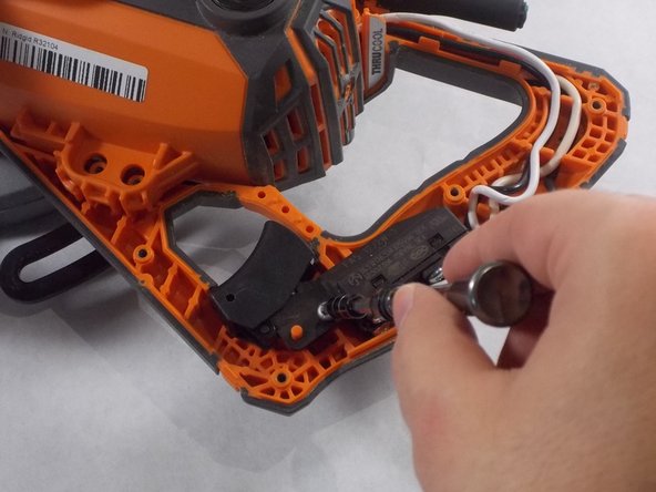

    • Place the Worm Drive Saw on its side to help remove the trigger.
    • Use the Torque 20 screwdriver to remove the single 3/10 cm screw that attaches the trigger switch to the handle set.

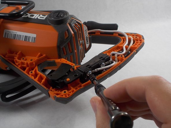

  5. RIDGID R32104 Trigger  Replacement: crwdns2935265:05crwdnd2935265:01crwdnd2935265:02crwdne2935265:0 RIDGID R32104 Trigger  Replacement: crwdns2935265:05crwdnd2935265:02crwdnd2935265:02crwdne2935265:0
    • Use the Phillips 2 screwdriver to remove the four 3/10 cm screws holding the trigger and four wires, from the main housing assembly, in place.
  6. RIDGID R32104 Trigger  Replacement: crwdns2935265:06crwdnd2935265:01crwdnd2935265:01crwdne2935265:0
    • Remove the trigger switch and trigger from the handle set.
