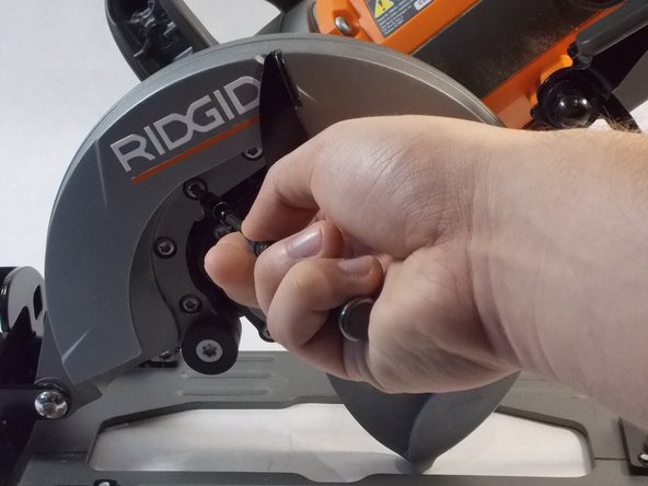

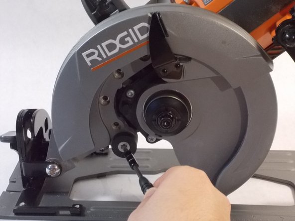

  4. RIDGID R32104 Motor Bearings Replacement, Upper Blade Guard Assembly: crwdns2935265:04crwdnd2935265:01crwdnd2935265:03crwdne2935265:0 RIDGID R32104 Motor Bearings Replacement, Upper Blade Guard Assembly: crwdns2935265:04crwdnd2935265:02crwdnd2935265:03crwdne2935265:0 RIDGID R32104 Motor Bearings Replacement, Upper Blade Guard Assembly: crwdns2935265:04crwdnd2935265:03crwdnd2935265:03crwdne2935265:0
    • Maneuver the RIDGID saw, in order to easily remove the upper blade guard assembly.
    • Using the T20 Torx Screwdriver, remove the four 4/10 cm screws that attach to the gear box.

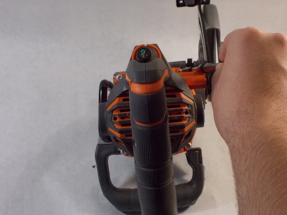

  5. RIDGID R32104 Motor Bearings Replacement: crwdns2935265:05crwdnd2935265:01crwdnd2935265:02crwdne2935265:0 RIDGID R32104 Motor Bearings Replacement: crwdns2935265:05crwdnd2935265:02crwdnd2935265:02crwdne2935265:0
    • Using the T50 Torx Screwdriver, remove the one 5/10 screw that attach to the gear box.

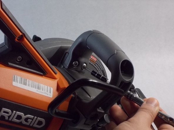

  6. RIDGID R32104 Motor Bearings Replacement: crwdns2935265:06crwdnd2935265:01crwdnd2935265:02crwdne2935265:0 RIDGID R32104 Motor Bearings Replacement: crwdns2935265:06crwdnd2935265:02crwdnd2935265:02crwdne2935265:0
    • Using the T20 Torx Screwdriver, remove the two 4/10 cm screws that attach to the handle of the device.

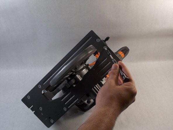

    • Maneuver the saw to get to the base plate.
    • Using the T20 Torx Screwdriver, remove the two 4/10 cm screws that attach the upper blade guard’s base plate to the main housing assembly.

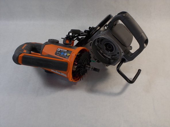

  9. RIDGID R32104 Motor Bearings Replacement, Gear Box: crwdns2935265:09crwdnd2935265:01crwdnd2935265:02crwdne2935265:0 RIDGID R32104 Motor Bearings Replacement, Gear Box: crwdns2935265:09crwdnd2935265:02crwdnd2935265:02crwdne2935265:0

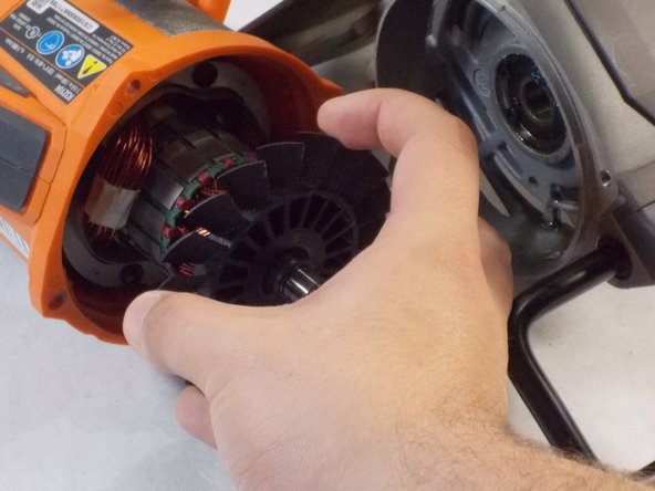

    • Wiggle out the gear box to easily gain access to the motor rotor.
    • Once taken out, the motor rotor is easily accessible.
  10. RIDGID R32104 Motor Bearings Replacement, Motor Rotor: crwdns2935265:010crwdnd2935265:01crwdnd2935265:03crwdne2935265:0 RIDGID R32104 Motor Bearings Replacement, Motor Rotor: crwdns2935265:010crwdnd2935265:02crwdnd2935265:03crwdne2935265:0 RIDGID R32104 Motor Bearings Replacement, Motor Rotor: crwdns2935265:010crwdnd2935265:03crwdnd2935265:03crwdne2935265:0
    • The motor rotor is lodged in between the armature and can be identified as a rod containing a fan blade.
    • Carefully remove the motor rotor from the device.
  11. RIDGID R32104 Motor Bearings Replacement, Motor Bearings: crwdns2935265:011crwdnd2935265:01crwdnd2935265:01crwdne2935265:0
    • The bearings are located on the opposite end of the motor rotor, from where the fan blade was.
    • Carefully remove the motor bearings from the motor rotor.
