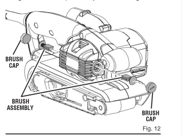

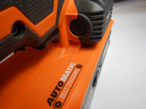

  5. RIDGID R2740 Motor Replacement: crwdns2935265:05crwdnd2935265:01crwdnd2935265:03crwdne2935265:0 RIDGID R2740 Motor Replacement: crwdns2935265:05crwdnd2935265:02crwdnd2935265:03crwdne2935265:0 RIDGID R2740 Motor Replacement: crwdns2935265:05crwdnd2935265:03crwdnd2935265:03crwdne2935265:0
    • Remove the brush caps from either side using a flathead screwdriver (See attached diagram).
    • Remove the plastic cover with the Ridgid logo.
    • Remove the brush assembly (See attached diagram).

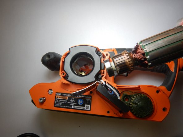

  6. RIDGID R2740 Motor Replacement: crwdns2935265:06crwdnd2935265:01crwdnd2935265:02crwdne2935265:0 RIDGID R2740 Motor Replacement: crwdns2935265:06crwdnd2935265:02crwdnd2935265:02crwdne2935265:0
    • Now orient the Rigid Sander to the other side that shows the exposed motor.
    • The motor will be able to lift up out of place.
