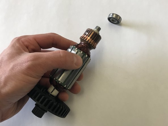

  3. RIDGID R2740 Ball Bearing Replacement: crwdns2935265:03crwdnd2935265:01crwdnd2935265:02crwdne2935265:0 RIDGID R2740 Ball Bearing Replacement: crwdns2935265:03crwdnd2935265:02crwdnd2935265:02crwdne2935265:0
    • Use a hammer to pry the ball bearing from the assembly armature.
    • The ball bearing can be somewhat difficult to remove. You may need to apply WD-40 before removal.
