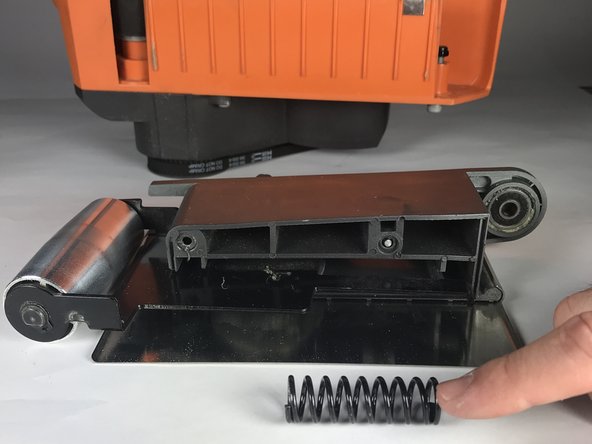

    • Turn the belt sander so that the RIDGID logo is facing you.
    • Flip the tension lever to the open position so that the tension on the spring is released.
    • Remove any sandpaper that is on the belt sander.
  2. RIDGID Belt Sander R2740 Tension Lever Spring Replacement: crwdns2935265:02crwdnd2935265:01crwdnd2935265:03crwdne2935265:0 RIDGID Belt Sander R2740 Tension Lever Spring Replacement: crwdns2935265:02crwdnd2935265:02crwdnd2935265:03crwdne2935265:0 RIDGID Belt Sander R2740 Tension Lever Spring Replacement: crwdns2935265:02crwdnd2935265:03crwdnd2935265:03crwdne2935265:0
    • Using the T20 Torx Screwdriver, remove the two (2) M4 X 19 mm screws on either side of the the belt tension release lever.
    • Remove the side plate to reveal the spring.
  3. RIDGID Belt Sander R2740 Tension Lever Spring Replacement: crwdns2935265:03crwdnd2935265:01crwdnd2935265:02crwdne2935265:0 RIDGID Belt Sander R2740 Tension Lever Spring Replacement: crwdns2935265:03crwdnd2935265:02crwdnd2935265:02crwdne2935265:0
    • Remove and replace the spring (OD 14.47mm X 38.1mm).
