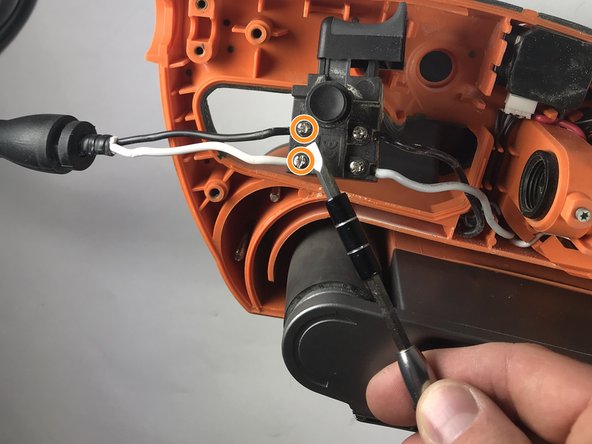

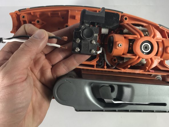

  3. RIDGID Belt Sander R2740 Power Cord Replacement: crwdns2935265:03crwdnd2935265:01crwdnd2935265:03crwdne2935265:0 RIDGID Belt Sander R2740 Power Cord Replacement: crwdns2935265:03crwdnd2935265:02crwdnd2935265:03crwdne2935265:0 RIDGID Belt Sander R2740 Power Cord Replacement: crwdns2935265:03crwdnd2935265:03crwdnd2935265:03crwdne2935265:0
    • Lift the power cord from the resting grooves.
    • Rotate the switch so that the lock-on button is facing you.
    • Loosen the two 8 mm Phillips #3 screws.
    • Pull the two wires away from the switch.

On the motor cover, the upper left screw is the same as for handle screws, the other 3 are 2inches. In testing the switch with an ohm meter, the motor resistance is 50M ohms. So with switch off, there is a infinity, very high and the tens of Mega ohms. I also disconnected the output wires, connected to a spare power cord ( white is hot, black is return. On you right hand, if the thumb is earth ground, then the middle is hot, index is return.) For me it ran fine. Just to check I put the wires back into the switch and it now works. Maybe a poor wire to the switch. Pays to rewire and just check again. Every is very clean, dust bag still doesn't work.
