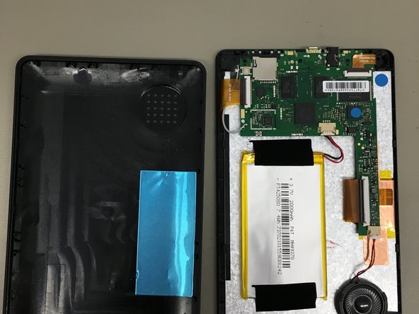

  5. RCA Voyager II RCT6773W22 Disassembly: crwdns2935265:05crwdnd2935265:01crwdnd2935265:02crwdne2935265:0 RCA Voyager II RCT6773W22 Disassembly: crwdns2935265:05crwdnd2935265:02crwdnd2935265:02crwdne2935265:0
    • lift section out of the black casing from the bottom, lift and remove by pulling away from tablet.

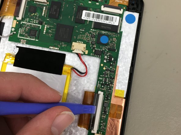

  8. RCA Voyager II RCT6773W22 Disassembly: crwdns2935265:08crwdnd2935265:01crwdnd2935265:01crwdne2935265:0
    • unplug the speaker

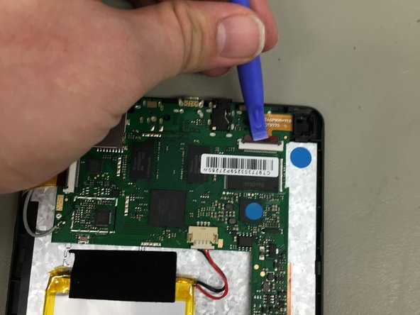

  9. RCA Voyager II RCT6773W22 Disassembly: crwdns2935265:09crwdnd2935265:01crwdnd2935265:03crwdne2935265:0 RCA Voyager II RCT6773W22 Disassembly: crwdns2935265:09crwdnd2935265:02crwdnd2935265:03crwdne2935265:0 RCA Voyager II RCT6773W22 Disassembly: crwdns2935265:09crwdnd2935265:03crwdnd2935265:03crwdne2935265:0
    • Lift the black cover over all three flex cables (Camera, LCD, Digitizer) with a plastic tool.
    • The covers are incredibly fragile, and easy to break
    • gently disconnect all three cables with your fingers by pulling slightly

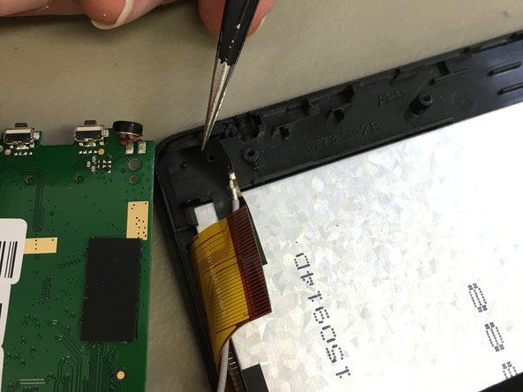

  11. RCA Voyager II RCT6773W22 Disassembly: crwdns2935265:011crwdnd2935265:01crwdnd2935265:02crwdne2935265:0 RCA Voyager II RCT6773W22 Disassembly: crwdns2935265:011crwdnd2935265:02crwdnd2935265:02crwdne2935265:0
    • lift the board out gently
    • Do not tug the board out too hard, the antenna cable on the left is soldered in!
    • Fold board over the left side of the tablet and gently remove tape securing antenna to the case. Use a small amount of heat if necessary.

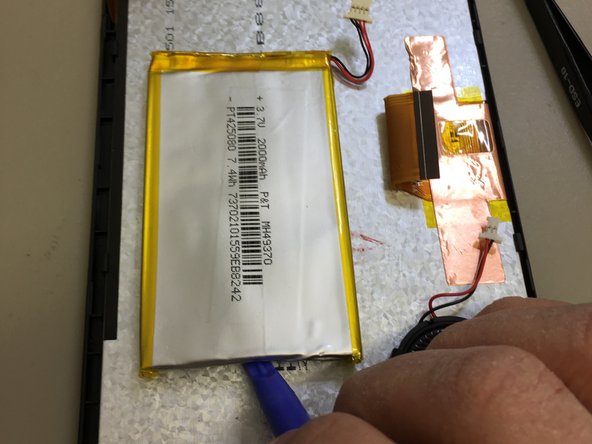

  12. RCA Voyager II RCT6773W22 Disassembly: crwdns2935265:012crwdnd2935265:01crwdnd2935265:02crwdne2935265:0 RCA Voyager II RCT6773W22 Disassembly: crwdns2935265:012crwdnd2935265:02crwdnd2935265:02crwdne2935265:0
    • remove tape from top and bottom of the battery.
    • with a plastic piece, lift battery from adhesive securing it in place.
    • do not use a metal or sharp tool to remove the battery, tearing or puncturing it may cause it to explode or heat rapidly, and may damage your device.
    • The battery is secured directly to the back of the LCD. Exercise caution while removing the battery not to damage the LCD.
    • The battery is soft and somewhat malleable - it can bend slightly without damage.

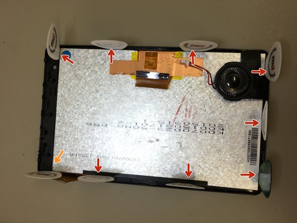

  13. RCA Voyager II RCT6773W22 Disassembly: crwdns2935265:013crwdnd2935265:01crwdnd2935265:02crwdne2935265:0 RCA Voyager II RCT6773W22 Disassembly: crwdns2935265:013crwdnd2935265:02crwdnd2935265:02crwdne2935265:0
    • Place picks between the lcd and the plastic clips holding it in place.
    • The pick placement to the top left side (near the power button) is smaller and on a corner. I recommend inserting this pick last.
  14. RCA Voyager II RCT6773W22 Disassembly: crwdns2935265:014crwdnd2935265:01crwdnd2935265:01crwdne2935265:0
    • Gently push top right pick down to lift LCD from the clip. Run across the top and right side to further lift LCD.
    • Use picks as needed to separate LCD in other areas.
  15. RCA Voyager II RCT6773W22 Disassembly: crwdns2935265:015crwdnd2935265:01crwdnd2935265:01crwdne2935265:0
    • Once separated and loose, remove picks so you do not damage the LCD while removing it.
    • To remove, lift top of LCD and pull out of case away from the speaker, which is fixed to the digitizer frame.

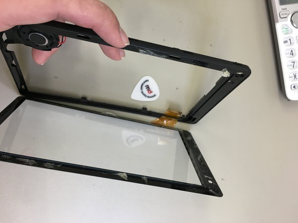

  16. RCA Voyager II RCT6773W22 Disassembly: crwdns2935265:016crwdnd2935265:01crwdnd2935265:02crwdne2935265:0 RCA Voyager II RCT6773W22 Disassembly: crwdns2935265:016crwdnd2935265:02crwdnd2935265:02crwdne2935265:0
    • to remove Digitizer/Glass from the frame and speaker, slide a pick under a corner between the glass and frame to loosen adhesive
    • If you're having issues loosening the adhesive, use a heat gun around the edges, then try again.
  17. RCA Voyager II RCT6773W22 Disassembly: crwdns2935265:017crwdnd2935265:01crwdnd2935265:01crwdne2935265:0
    • You have completely dismantled the RCA Voyager II
