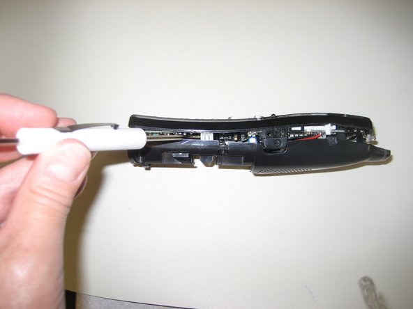

      • Insert a small flathead screwdriver between the face plate and the back of the handset.
      • Gently pry open the handset. You may need to insert the flathead screwdiver at multiple points in order to open the handset.

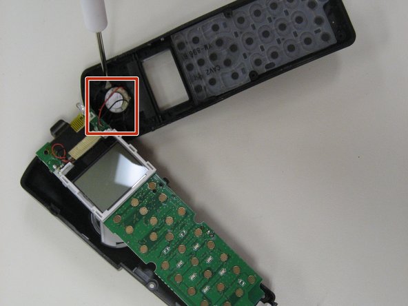

    3. RCA Visys 25212 Keypad Replacement: crwdns2935265:05crwdnd2935265:01crwdnd2935265:01crwdne2935265:0
      • Using a small Phillips head screwdriver, remove the single screw (located at the top right) holding the circuit board in place.
    4. RCA Visys 25212 Keypad Replacement: crwdns2935265:06crwdnd2935265:01crwdnd2935265:02crwdne2935265:0 RCA Visys 25212 Keypad Replacement: crwdns2935265:06crwdnd2935265:02crwdnd2935265:02crwdne2935265:0
      • Lift up the circuit board to expose the keypad.
      • Be careful not to disconnect the two wires that connect the speaker to the circuit board.
      • Also, notice the two wires located at the bottom when lifting the circuit board, as these are apart of the charger.
