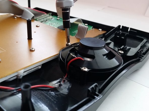

  4. RCA ViSYS 25424RE1 Speaker Replacement, Speaker: crwdns2935265:04crwdnd2935265:01crwdnd2935265:03crwdne2935265:0 RCA ViSYS 25424RE1 Speaker Replacement, Speaker: crwdns2935265:04crwdnd2935265:02crwdnd2935265:03crwdne2935265:0 RCA ViSYS 25424RE1 Speaker Replacement, Speaker: crwdns2935265:04crwdnd2935265:03crwdnd2935265:03crwdne2935265:0
    • Use a Phillips #00 screwdriver to remove the three 11mm screws to separate the speaker from its base.

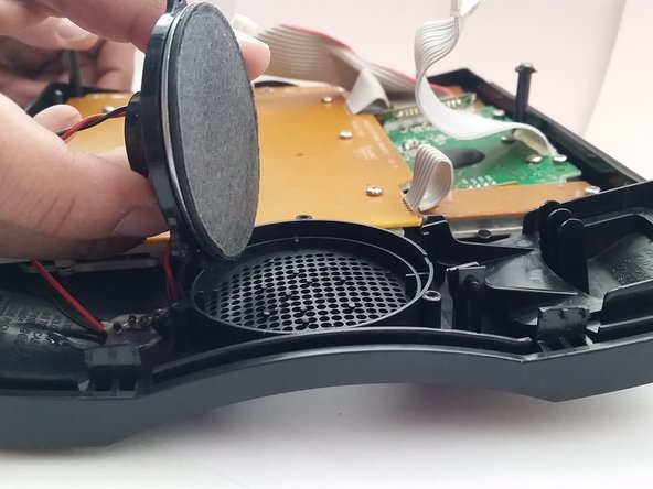

  5. RCA ViSYS 25424RE1 Speaker Replacement: crwdns2935265:05crwdnd2935265:01crwdnd2935265:02crwdne2935265:0 RCA ViSYS 25424RE1 Speaker Replacement: crwdns2935265:05crwdnd2935265:02crwdnd2935265:02crwdne2935265:0
    • Once the screws are taken out, use tweezers to remove the hot glue from the wires.
    • Be careful when removing the hot glue to ensure that the wires remain intact.
