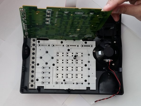

    • Use a plastic opening tool to separate the back and front pieces.
    • Gently remove the back cover, because the wires are connected to each piece.
  3. RCA ViSYS 25424RE1 Keypad Replacement: crwdns2935265:03crwdnd2935265:01crwdnd2935265:03crwdne2935265:0 RCA ViSYS 25424RE1 Keypad Replacement: crwdns2935265:03crwdnd2935265:02crwdnd2935265:03crwdne2935265:0 RCA ViSYS 25424RE1 Keypad Replacement: crwdns2935265:03crwdnd2935265:03crwdnd2935265:03crwdne2935265:0
    • Unclip the wires that connect the front piece to the circuit board on the back piece.
  4. RCA ViSYS 25424RE1 Keypad Replacement, Keypad: crwdns2935265:04crwdnd2935265:01crwdnd2935265:02crwdne2935265:0 RCA ViSYS 25424RE1 Keypad Replacement, Keypad: crwdns2935265:04crwdnd2935265:02crwdnd2935265:02crwdne2935265:0
    • Remove the nine 11mm screws from the board using a Phillips #00 screwdriver, in order to expose the keyboard pressure sensors.

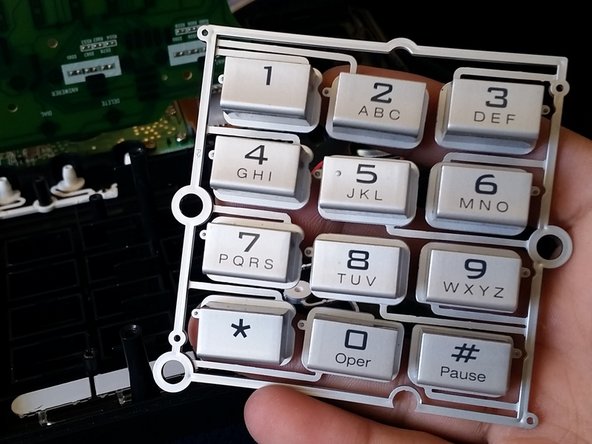

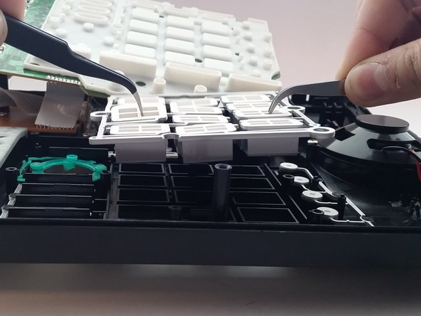

    • Lift the rubber keypad.
    • Use a pair of tweezers to lift the number pad from both ends at the same time.
