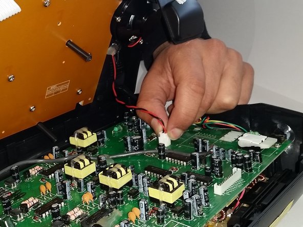

    • Remove the eight 11mm screws found on the bottom side of the base with a Phillips #00 screwdriver.
  2. RCA ViSYS 25424RE1 Base Disassembly: crwdns2935265:02crwdnd2935265:01crwdnd2935265:03crwdne2935265:0 RCA ViSYS 25424RE1 Base Disassembly: crwdns2935265:02crwdnd2935265:02crwdnd2935265:03crwdne2935265:0 RCA ViSYS 25424RE1 Base Disassembly: crwdns2935265:02crwdnd2935265:03crwdnd2935265:03crwdne2935265:0
    • Use a plastic opening tool to separate the back and front pieces.
    • Gently remove the back cover, because the wires are connected to each piece.
  3. RCA ViSYS 25424RE1 Base Disassembly: crwdns2935265:03crwdnd2935265:01crwdnd2935265:03crwdne2935265:0 RCA ViSYS 25424RE1 Base Disassembly: crwdns2935265:03crwdnd2935265:02crwdnd2935265:03crwdne2935265:0 RCA ViSYS 25424RE1 Base Disassembly: crwdns2935265:03crwdnd2935265:03crwdnd2935265:03crwdne2935265:0
    • Unclip the wires that connect the front piece to the circuit board on the back piece.
