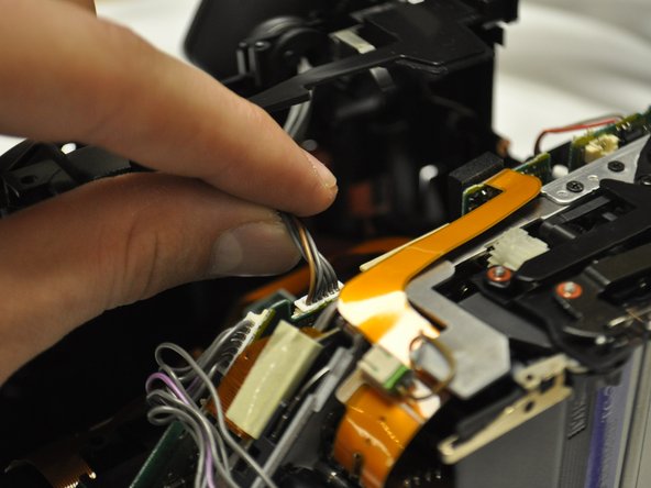

    • Remove the 5 screws that secure the control panel (located on the top of the device) by using your small flathead screwdriver.
    • Loosen the panel from the device until you are able to remove it.
  2. RCA Small Wonders Camcorder CC176 Viewfinder Replacement: crwdns2935265:02crwdnd2935265:01crwdnd2935265:03crwdne2935265:0 RCA Small Wonders Camcorder CC176 Viewfinder Replacement: crwdns2935265:02crwdnd2935265:02crwdnd2935265:03crwdne2935265:0 RCA Small Wonders Camcorder CC176 Viewfinder Replacement: crwdns2935265:02crwdnd2935265:03crwdnd2935265:03crwdne2935265:0
    • Remove the remaining 21 screws on the camcorder.
    • Begin separating the plastic casing from the inner components of the device.
  3. RCA Small Wonders Camcorder CC176 Viewfinder Replacement: crwdns2935265:03crwdnd2935265:01crwdnd2935265:02crwdne2935265:0 RCA Small Wonders Camcorder CC176 Viewfinder Replacement: crwdns2935265:03crwdnd2935265:02crwdnd2935265:02crwdne2935265:0
    • Grasping the viewfinder in hand, carefully remove the two screws that secure the mounting device.
    • Locate the gray electrical cord that connects the viewfinder to the inner components of the camera. Gently unplug the gray cord and loosen the viewfinder from the device.
    • Separate the viewfinder from the device and feed the gray cord through the hole in the plastic casing.
