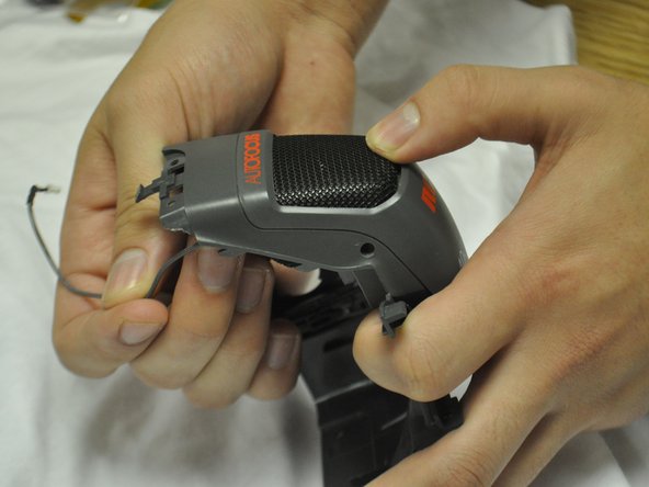

    • Remove the small black screws along the edges of the control panel on the top of the device.
    • Pry off the top control panel using the plastic wedge tool.
    • Remove the screw from the front, gray panel located beneath the "Scene Select AE" label.
    • Remove the two small black screws on the top of the front, gray panel of the device, above the red AUTOFOCUS letters.
  2. RCA Small Wonders Camcorder CC176 Speaker Replacement: crwdns2935265:02crwdnd2935265:01crwdnd2935265:01crwdne2935265:0
    • Turn the device over and remove the two screws securing the front panel of the device.
    • Remove the screw securing the primary viewfinder, along the front of the camera.
    • Using a flat plastic tool, pry the entire front panel away from the device.
  3. RCA Small Wonders Camcorder CC176 Speaker Replacement: crwdns2935265:03crwdnd2935265:01crwdnd2935265:02crwdne2935265:0 RCA Small Wonders Camcorder CC176 Speaker Replacement: crwdns2935265:03crwdnd2935265:02crwdnd2935265:02crwdne2935265:0
    • Gently unplug the grey cord, located underneath the panel, disconnecting the speaker from the inner component of the device.
    • Remove the speaker from the device.
