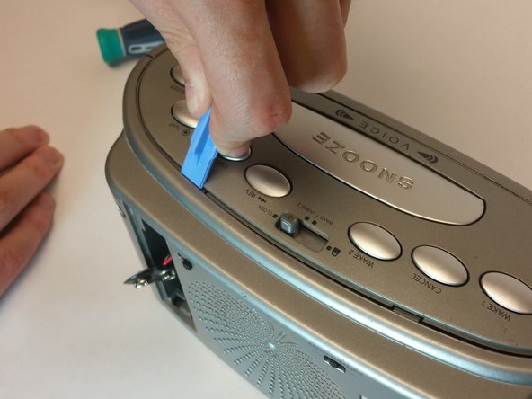

    • Using flathead screwdriver undo the release tabs.

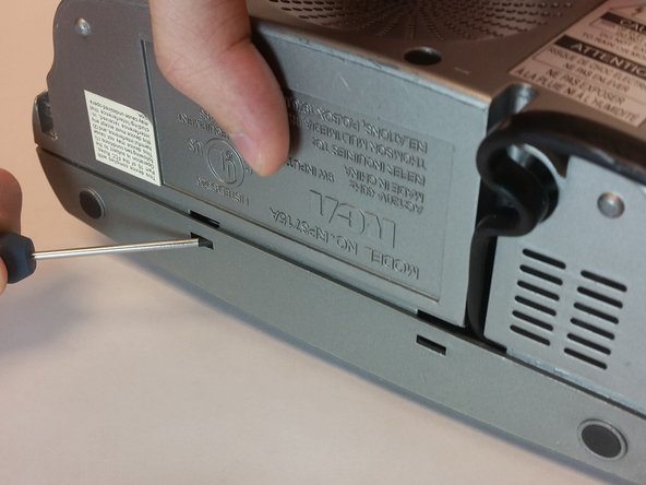

  4. RCA RP3715A Motherboard Replacement: crwdns2935265:04crwdnd2935265:01crwdnd2935265:03crwdne2935265:0 RCA RP3715A Motherboard Replacement: crwdns2935265:04crwdnd2935265:02crwdnd2935265:03crwdne2935265:0 RCA RP3715A Motherboard Replacement: crwdns2935265:04crwdnd2935265:03crwdnd2935265:03crwdne2935265:0

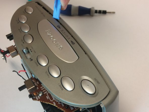

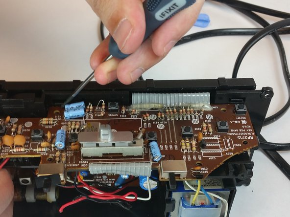

    • Pry the release tabs with a spudger.
    • Start with back of the device on the topside.
  5. RCA RP3715A Motherboard Replacement: crwdns2935265:05crwdnd2935265:01crwdnd2935265:02crwdne2935265:0 RCA RP3715A Motherboard Replacement: crwdns2935265:05crwdnd2935265:02crwdnd2935265:02crwdne2935265:0

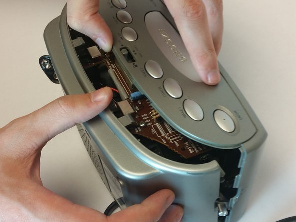

    • Pry open both tabs to remove the topside of the clock.

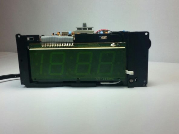

    • The two latches located in the picture will help take off the display.
    • Remove the display.

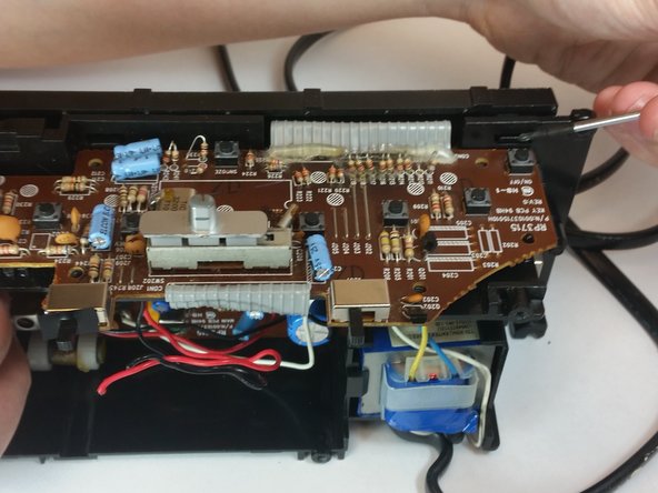

  11. RCA RP3715A Motherboard Replacement, Removing the top part of motherboard: crwdns2935265:011crwdnd2935265:01crwdnd2935265:01crwdne2935265:0
    • Remove the top 5 10mm Phillips #1 screws holding the top part of the motherboard
  12. RCA RP3715A Motherboard Replacement, Removing the side part of motherboard: crwdns2935265:012crwdnd2935265:01crwdnd2935265:01crwdne2935265:0
    • Remove the 5 10mm Phillip's #1 screws that holding side part of the motherboard
  13. RCA RP3715A Motherboard Replacement: crwdns2935265:013crwdnd2935265:01crwdnd2935265:01crwdne2935265:0
    • Remove the transformer by pulling back the release tab shown.
  14. RCA RP3715A Motherboard Replacement: crwdns2935265:014crwdnd2935265:01crwdnd2935265:01crwdne2935265:0
    • Pull the battery terminal through the whole shown.

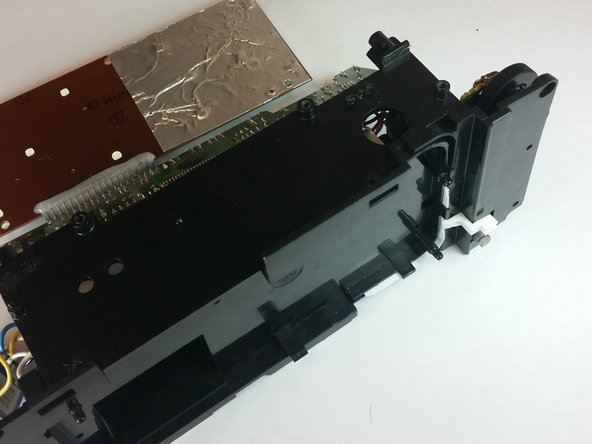

  15. RCA RP3715A Motherboard Replacement, Lift the digital screen: crwdns2935265:015crwdnd2935265:01crwdnd2935265:01crwdne2935265:0
    • First release the latch highlighted in the picture. Then grab the screen by the bottom and lift it up.

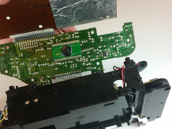

  16. RCA RP3715A Motherboard Replacement, Lift the top piece of motherboard: crwdns2935265:016crwdnd2935265:01crwdnd2935265:03crwdne2935265:0 RCA RP3715A Motherboard Replacement, Lift the top piece of motherboard: crwdns2935265:016crwdnd2935265:02crwdnd2935265:03crwdne2935265:0 RCA RP3715A Motherboard Replacement, Lift the top piece of motherboard: crwdns2935265:016crwdnd2935265:03crwdnd2935265:03crwdne2935265:0
    • Remove the motherboard from the frame using the illustration shown.
