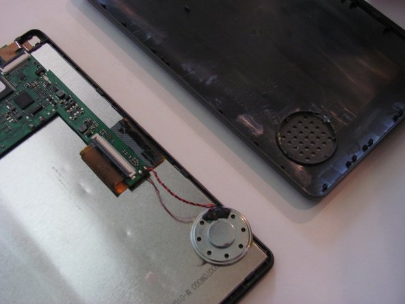

    • Place the plastic opening tool between the case and the screen.
    • Slide the tool clockwise around the case until all the clips are removed.
    • Do not completely separate the case from the screen because there is a wire connecting the motherboard to the speaker.

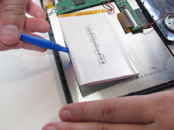

  3. RCA RCT6773W22 Motherboard Replacement: crwdns2935265:03crwdnd2935265:01crwdnd2935265:03crwdne2935265:0 RCA RCT6773W22 Motherboard Replacement: crwdns2935265:03crwdnd2935265:02crwdnd2935265:03crwdne2935265:0 RCA RCT6773W22 Motherboard Replacement: crwdns2935265:03crwdnd2935265:03crwdnd2935265:03crwdne2935265:0

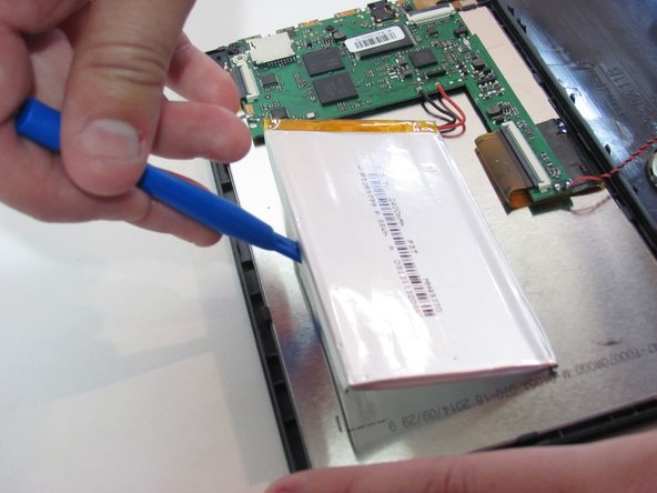

    • Desolder the two wires that connect the battery to the motherboard.
    • Learn more about soldering with this soldering technique guide.
    • Using the blue plastic opening tool, lift the battery away from the device.

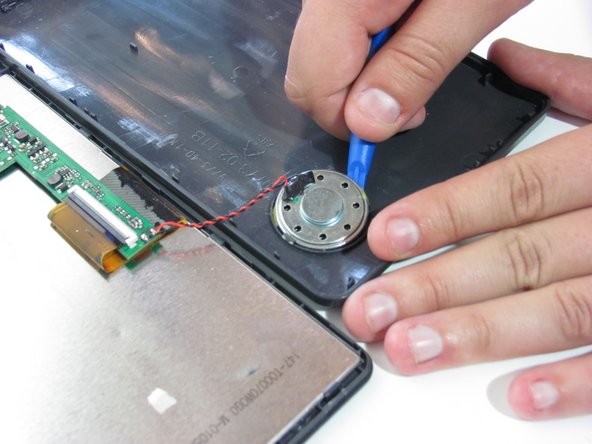

  4. RCA RCT6773W22 Motherboard Replacement, Speaker: crwdns2935265:04crwdnd2935265:01crwdnd2935265:03crwdne2935265:0 RCA RCT6773W22 Motherboard Replacement, Speaker: crwdns2935265:04crwdnd2935265:02crwdnd2935265:03crwdne2935265:0 RCA RCT6773W22 Motherboard Replacement, Speaker: crwdns2935265:04crwdnd2935265:03crwdnd2935265:03crwdne2935265:0
    • Desolder the wire connected from the speaker to the motherboard.
    • Pry the speaker from the casing with a plastic opening tool.

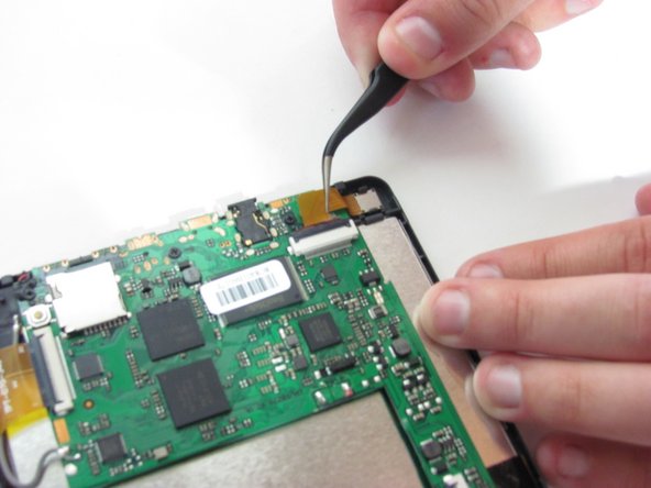

  5. RCA RCT6773W22 Motherboard Replacement, Motherboard: crwdns2935265:05crwdnd2935265:01crwdnd2935265:03crwdne2935265:0 RCA RCT6773W22 Motherboard Replacement, Motherboard: crwdns2935265:05crwdnd2935265:02crwdnd2935265:03crwdne2935265:0 RCA RCT6773W22 Motherboard Replacement, Motherboard: crwdns2935265:05crwdnd2935265:03crwdnd2935265:03crwdne2935265:0
    • Use the spudger to lift up the black tab on all three ZIF connectors.
    • Use tweezers to remove the ribbon cables from the zift connectors.

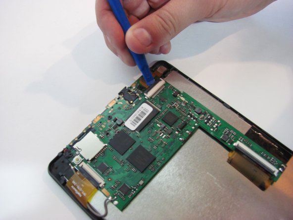

  6. RCA RCT6773W22 Motherboard Replacement: crwdns2935265:06crwdnd2935265:01crwdnd2935265:01crwdne2935265:0
    • Use Phillips #000 screwdriver to remove the three 3mm screws on the motherboard.
  7. RCA RCT6773W22 Motherboard Replacement: crwdns2935265:07crwdnd2935265:01crwdnd2935265:02crwdne2935265:0 RCA RCT6773W22 Motherboard Replacement: crwdns2935265:07crwdnd2935265:02crwdnd2935265:02crwdne2935265:0

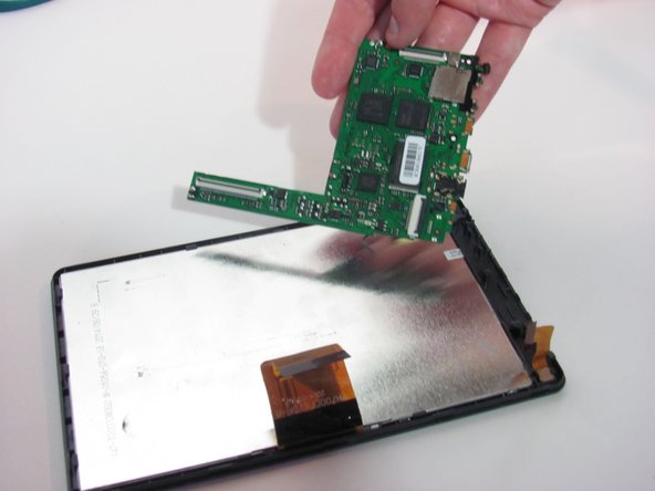

    • Use a spudger or plastic opening tool to lift up the motherboard.
