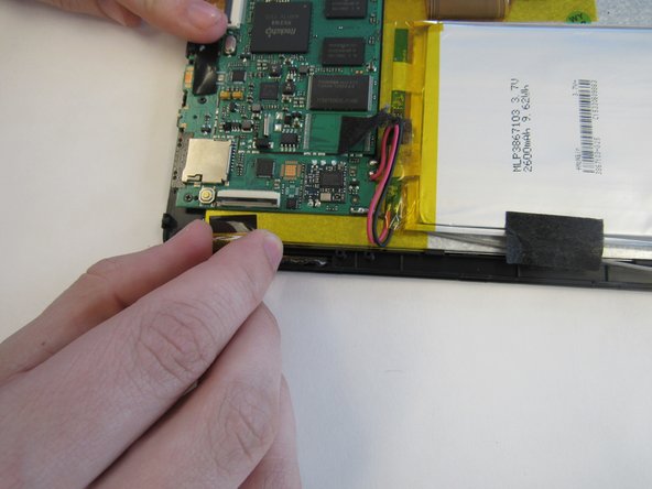

    • Using the tweezers, remove the black tape connecting the screen to the motherboard.
  4. RCA RCT6378W2 Screen Replacement: crwdns2935265:04crwdnd2935265:01crwdnd2935265:02crwdne2935265:0 RCA RCT6378W2 Screen Replacement: crwdns2935265:04crwdnd2935265:02crwdnd2935265:02crwdne2935265:0

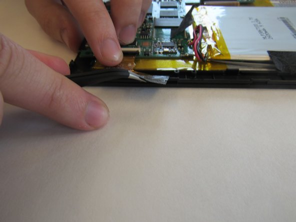

    • Pull up the switch to remove the input connector.

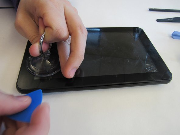

    • Heat the iOpener in the microwave, following the instructions provided with the tool. Lay the heated iOpener on the front screen for two minutes to soften the connection of the screen to the tablet.
  6. RCA RCT6378W2 Screen Replacement: crwdns2935265:06crwdnd2935265:01crwdnd2935265:02crwdne2935265:0 RCA RCT6378W2 Screen Replacement: crwdns2935265:06crwdnd2935265:02crwdnd2935265:02crwdne2935265:0
    • Use the suction cup and plastic opening tool to pry the front screen from the tablet.
