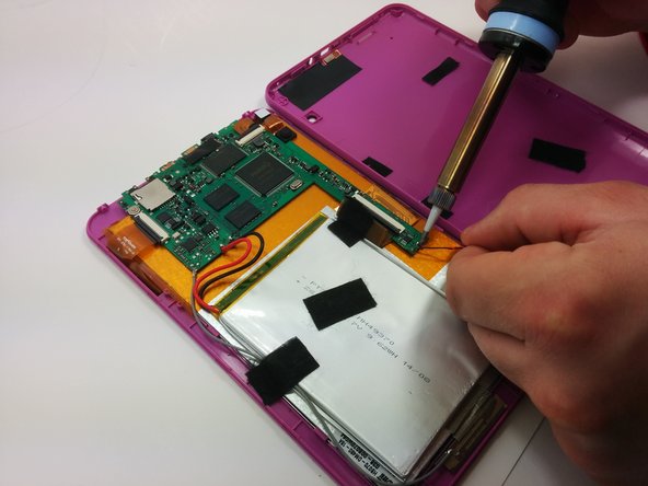

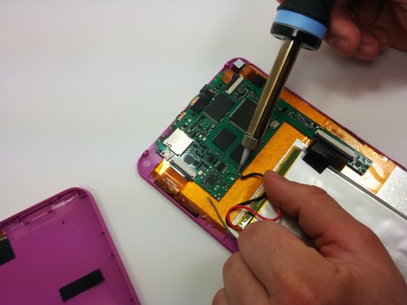

    1. RCA RCT6272W23 Display Replacement, Motherboard: crwdns2935265:03crwdnd2935265:01crwdnd2935265:03crwdne2935265:0 RCA RCT6272W23 Display Replacement, Motherboard: crwdns2935265:03crwdnd2935265:02crwdnd2935265:03crwdne2935265:0 RCA RCT6272W23 Display Replacement, Motherboard: crwdns2935265:03crwdnd2935265:03crwdnd2935265:03crwdne2935265:0
      • Use a soldering iron to remove the soldered connections on the motherboard
      • For your safety and to ensure a correct repair, be sure to exercise caution when using the soldering iron.
      • For more information about soldering, check out this guide.

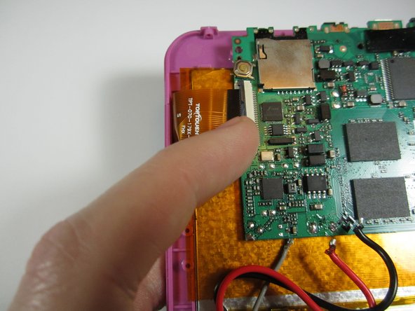

    3. RCA RCT6272W23 Display Replacement: crwdns2935265:05crwdnd2935265:01crwdnd2935265:02crwdne2935265:0 RCA RCT6272W23 Display Replacement: crwdns2935265:05crwdnd2935265:02crwdnd2935265:02crwdne2935265:0
      • Use your fingers to pop the three black tabs up to release the flat plastic data transfer cables.

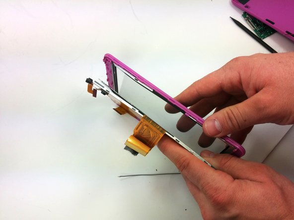

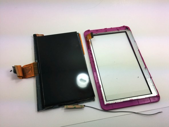

    2. RCA RCT6272W23 Display Replacement: crwdns2935265:08crwdnd2935265:01crwdnd2935265:03crwdne2935265:0 RCA RCT6272W23 Display Replacement: crwdns2935265:08crwdnd2935265:02crwdnd2935265:03crwdne2935265:0 RCA RCT6272W23 Display Replacement: crwdns2935265:08crwdnd2935265:03crwdnd2935265:03crwdne2935265:0
      • Using a spudger, separate the display surface from the front cover.
      • Be careful not to break the tabs that hold the display screen in place.
      • A second spudger may be necessary to help hold the position of the display screen.
