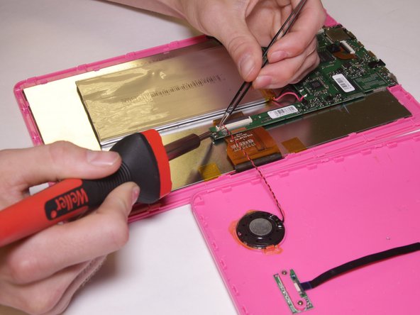

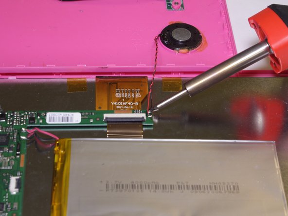

  3. RCA RCT6203W46 Rear Speaker Replacement: crwdns2935265:03crwdnd2935265:01crwdnd2935265:03crwdne2935265:0 RCA RCT6203W46 Rear Speaker Replacement: crwdns2935265:03crwdnd2935265:02crwdnd2935265:03crwdne2935265:0 RCA RCT6203W46 Rear Speaker Replacement: crwdns2935265:03crwdnd2935265:03crwdnd2935265:03crwdne2935265:0
    • With a soldering iron, remove the wires from the circuit board.
    • Due to the size of the wires, tweezers may be necessary.
