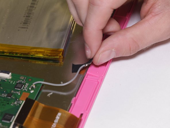

  7. RCA RCT6203W46 Rear Camera Replacement: crwdns2935265:07crwdnd2935265:01crwdnd2935265:02crwdne2935265:0 RCA RCT6203W46 Rear Camera Replacement: crwdns2935265:07crwdnd2935265:02crwdnd2935265:02crwdne2935265:0
    • Gently remove the grey tape that's covering the grey colored wire until it is completely peeled off.
    • Peel off the black piece of tape to remove the antenna.
