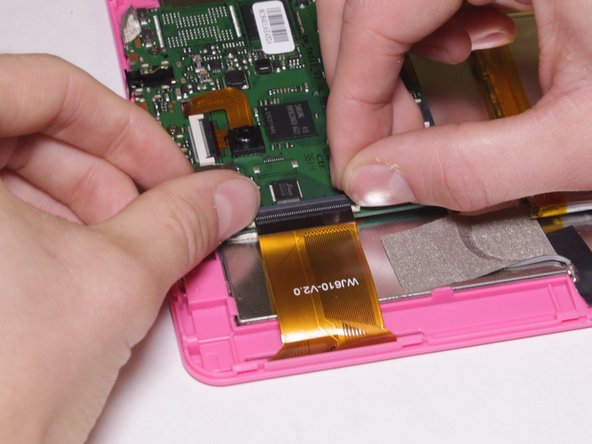

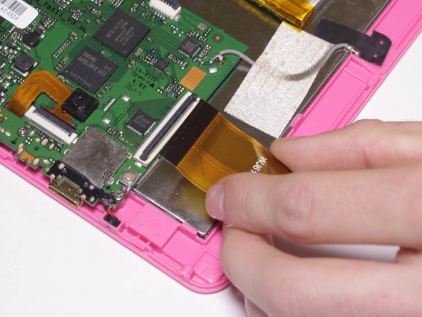

      • Unclip the three ribbon cables from the motherboard by lifting up on their latches (the black portions that the cables feed into) and gently pulling the cables.
      • The process is the same for all three ribbon wires.
      • Do not forcefully try to remove the cables. The latch may not be lifted up all the way, and using force can separate the cable from its connector, which can damage important components of the tablet.

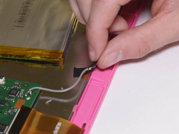

      • Carefully peel off these two pieces of tape to remove the antenna.

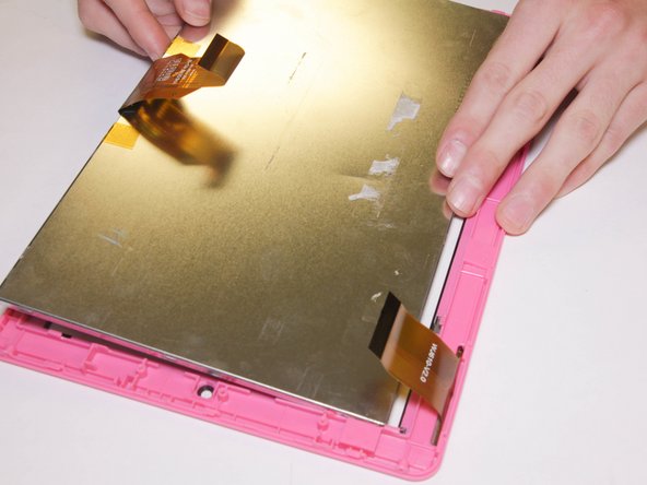

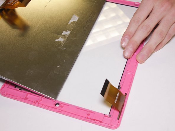

      • To remove the LCD from the screen casing, gently pry it out of the clips that are holding it in place.
      • If possible, use a plastic spudger. However, since the clips are tight, a metal spudger may be necessary.
      • Use of playing cards or guitar picks help to keep the clips from reattaching themselves to the device.
      • Focus on one half of the LCD, as the other half will come out easily when the first half comes loose.
      • Be careful not to damage the clips or LCD when prying.

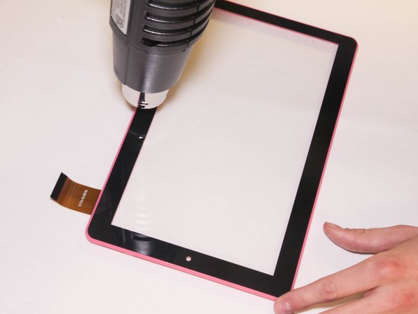

      • With a heat gun, heat along the border of the screen and case to weaken the glue.
      • Do not leave the heat gun pointed in one spot for long. This may warp or melt the plastic and make reassembly more difficult.
