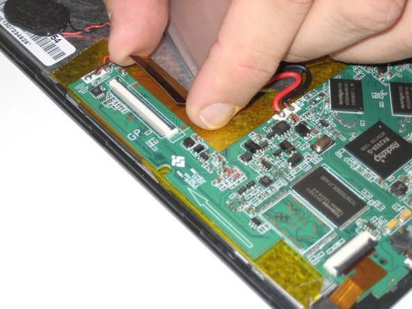

  5. RCA RCT6077W2 LCD Replacement: crwdns2935265:05crwdnd2935265:01crwdnd2935265:02crwdne2935265:0 RCA RCT6077W2 LCD Replacement: crwdns2935265:05crwdnd2935265:02crwdnd2935265:02crwdne2935265:0
    • Unclip the ribbon cables from the motherboard by lifting up on their latches (the black portions that the cables feed into) and gently pulling the cables.
    • Do not use force to try and remove the cables. The latch may not be lifted up all the way, and using force can separate the cable from its connector. This can damage important components of the tablet.

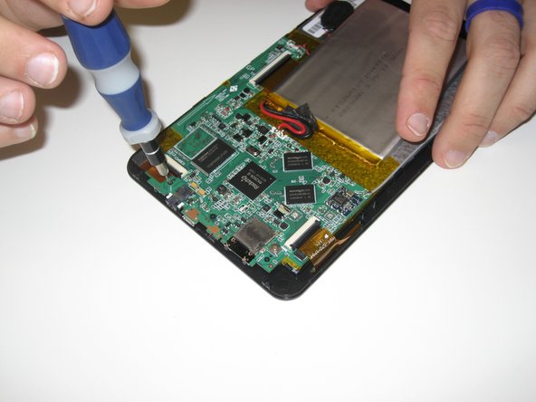

  6. RCA RCT6077W2 LCD Replacement: crwdns2935265:06crwdnd2935265:01crwdnd2935265:02crwdne2935265:0 RCA RCT6077W2 LCD Replacement: crwdns2935265:06crwdnd2935265:02crwdnd2935265:02crwdne2935265:0
    • Remove the three 2.5mm Phillips screws from the motherboard.
    • After removing the screws, use a plastic opening tool to gently pull the motherboard off of the double-sided tape holding it down.
