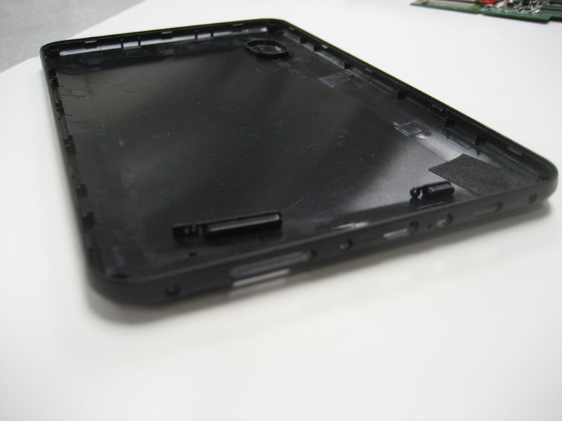

    1. RCA RCT6077W2 Backplate Replacement, Backplate: crwdns2935265:01crwdnd2935265:01crwdnd2935265:02crwdne2935265:0 RCA RCT6077W2 Backplate Replacement, Backplate: crwdns2935265:01crwdnd2935265:02crwdnd2935265:02crwdne2935265:0
      • Remove the two 2.5mm Phillips head screws before attempting to remove the screen from the device.
    2. RCA RCT6077W2 Backplate Replacement: crwdns2935265:02crwdnd2935265:01crwdnd2935265:02crwdne2935265:0 RCA RCT6077W2 Backplate Replacement: crwdns2935265:02crwdnd2935265:02crwdnd2935265:02crwdne2935265:0
      • Run an opening pick around the edge of the screen to loosen it and begin to pry upward.
      • When the screen comes up like it has in the photo, it should be able to simply be removed from its casing.
      • The buttons on the end of the device will be loose when you remove the screen from the backplate. Be careful not to lose them.
