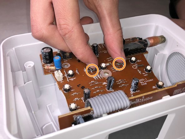

    • Remove the casing. Slide the plastic cover with the graphic off the main base. Be careful and hold both sides.
    • Flip the device over and unscrew the five 11 mm screws with a Phillip's #1 screwdriver.
    • A magnetic screwdriver will help you remove the screws from their slots.

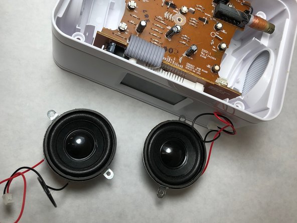

    • Pull the top of the device off and look closely at the motherboard. You will see two speakers, one on each side of the device.
    • Grab the tweezers and follow the red and black wires leading from the speaker to the motherboard. They will attach to a white casing. Lift the white plug out with the tweezers to disconnect.
  3. RCA RCR8622 Buttons Replacement: crwdns2935265:03crwdnd2935265:01crwdnd2935265:02crwdne2935265:0 RCA RCR8622 Buttons Replacement: crwdns2935265:03crwdnd2935265:02crwdnd2935265:02crwdne2935265:0
    • Grab the speaker and pull upward. The Speakers will be loose.
    • Repeat this step with the other speaker.

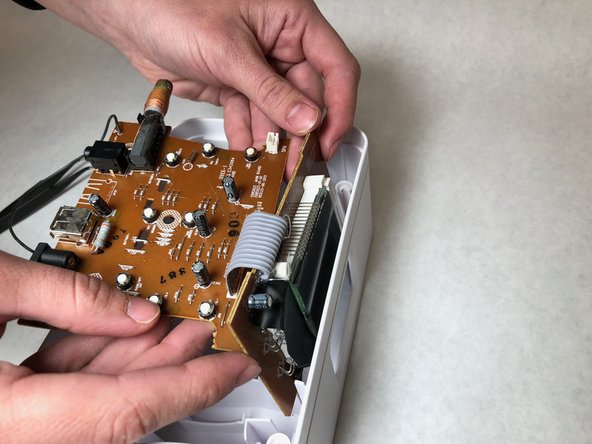

  5. RCA RCR8622 Buttons Replacement: crwdns2935265:05crwdnd2935265:01crwdnd2935265:03crwdne2935265:0 RCA RCR8622 Buttons Replacement: crwdns2935265:05crwdnd2935265:02crwdnd2935265:03crwdne2935265:0 RCA RCR8622 Buttons Replacement: crwdns2935265:05crwdnd2935265:03crwdnd2935265:03crwdne2935265:0

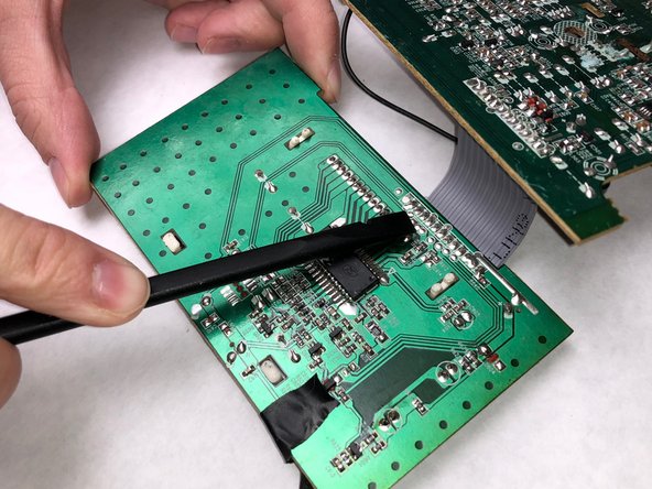

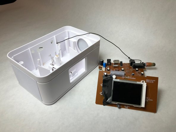

    • Lift the motherboard out of the interior of the device.
    • Remove the screen section of the device by lifting upward on the circuit it is connected to by sliding it upwards.
    • Both sections will be connected with a ribbon connection.

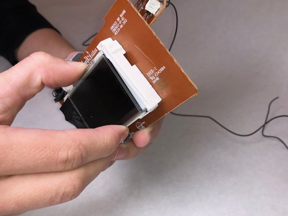

  6. RCA RCR8622 Buttons Replacement: crwdns2935265:06crwdnd2935265:01crwdnd2935265:03crwdne2935265:0 RCA RCR8622 Buttons Replacement: crwdns2935265:06crwdnd2935265:02crwdnd2935265:03crwdne2935265:0 RCA RCR8622 Buttons Replacement: crwdns2935265:06crwdnd2935265:03crwdnd2935265:03crwdne2935265:0

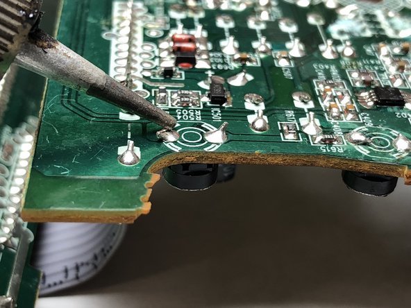

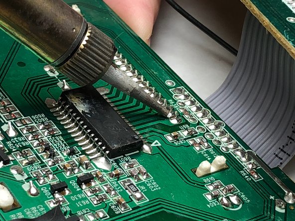

    • Flip both components of the circuitry over and from the main motherboard you will see metal pins that lead to the LCD screen.
    • Heat the solder around the pins with a soldering iron so the pins can be removed and the screen can be detached. Use a flat object to help push out the pins.
  7. RCA RCR8622 Buttons Replacement: crwdns2935265:07crwdnd2935265:01crwdnd2935265:02crwdne2935265:0 RCA RCR8622 Buttons Replacement: crwdns2935265:07crwdnd2935265:02crwdnd2935265:02crwdne2935265:0
    • Lift the screen upward, taking care not to allow the films below it to fall out.

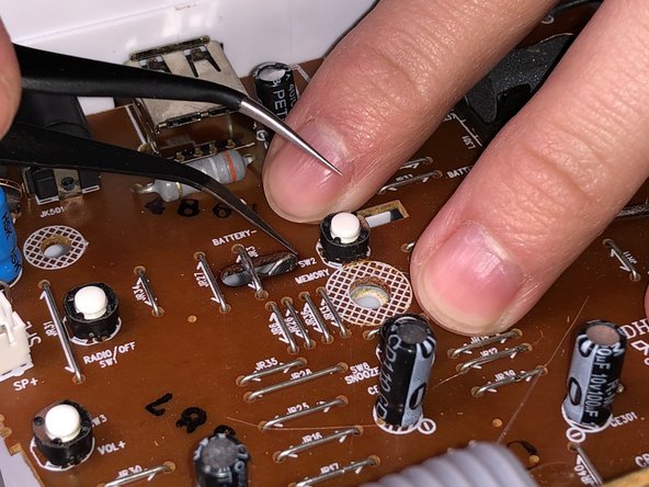

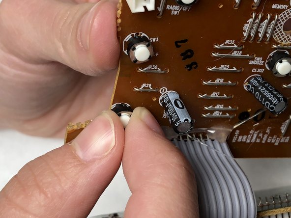

  8. RCA RCR8622 Buttons Replacement, Buttons: crwdns2935265:08crwdnd2935265:01crwdnd2935265:03crwdne2935265:0 RCA RCR8622 Buttons Replacement, Buttons: crwdns2935265:08crwdnd2935265:02crwdnd2935265:03crwdne2935265:0 RCA RCR8622 Buttons Replacement, Buttons: crwdns2935265:08crwdnd2935265:03crwdnd2935265:03crwdne2935265:0
    • Identify which button needs to be changed out. There will be lables on the board indicating functionality of each button.
    • Flip the board over and find the button by the circles on the board.
    • Solder the 2 pins off the button and pinch the top of the button on the other side to pull off.
