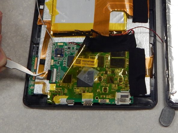

    • Using a separating tool, look for a seam in the plastic casing that looks most accessible.
    • Use the prying tool to separate the front and back casing, working your way around the perimeter.
    • Utilize a card tool or a pick to assist in keeping the case separated.
    • To reassemble the device simply align the two casing halves and pinch to snap together or press down on the edges while the device in on a table.

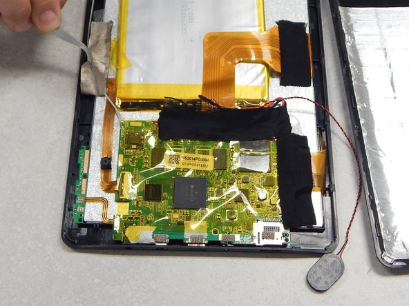

  2. RCA Pro10 Edition Camera Replacement: crwdns2935265:02crwdnd2935265:01crwdnd2935265:01crwdne2935265:0
    • Flip over the back of the device while keeping it close to the front, the speaker is attached to it.
    • Remove the yellow tape securing the speaker to the back casing.
  3. RCA Pro10 Edition Camera Replacement: crwdns2935265:03crwdnd2935265:01crwdnd2935265:02crwdne2935265:0 RCA Pro10 Edition Camera Replacement: crwdns2935265:03crwdnd2935265:02crwdnd2935265:02crwdne2935265:0
    • Use the separating tool to pry the speaker from its surface.
    • Use caution when removing the speaker, you may damage the screen.
    • Cut or desolder the wires to replace or repair the speaker.

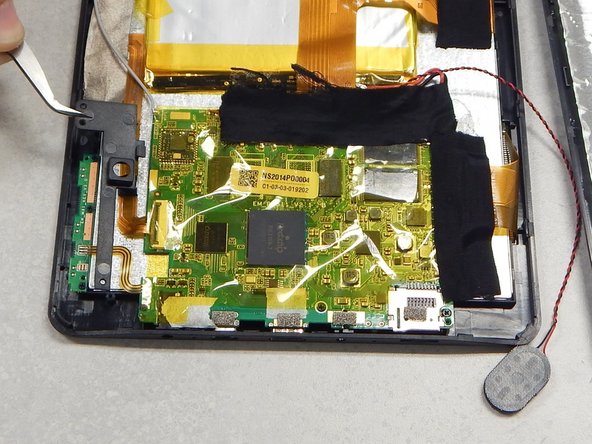

  4. RCA Pro10 Edition Camera Replacement, Camera: crwdns2935265:04crwdnd2935265:01crwdnd2935265:03crwdne2935265:0 RCA Pro10 Edition Camera Replacement, Camera: crwdns2935265:04crwdnd2935265:02crwdnd2935265:03crwdne2935265:0 RCA Pro10 Edition Camera Replacement, Camera: crwdns2935265:04crwdnd2935265:03crwdnd2935265:03crwdne2935265:0
    • Using a P00 Phillips screwdriver, remove the three screws securing the black plastic camera housing and remove it.
    • Peel back the beige tape while holding down the camera ribbon cable to prevent tears
  5. RCA Pro10 Edition Camera Replacement: crwdns2935265:05crwdnd2935265:01crwdnd2935265:02crwdne2935265:0 RCA Pro10 Edition Camera Replacement: crwdns2935265:05crwdnd2935265:02crwdnd2935265:02crwdne2935265:0
    • Lift the locking tab that is securing the camera ribbon cable.
    • Slide the ribbon cable out from the connector and remove from casing.
