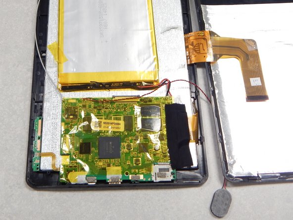

    • Using a separating tool, look for a seam in the plastic casing that looks most accessible.
    • Use the prying tool to separate the front and back casing, working your way around the perimeter.
    • Utilize a card tool or a pick to assist in keeping the case separated.
    • To reassemble the device simply align the two casing halves and pinch to snap together or press down on the edges while the device in on a table.
  2. RCA Pro10 Edition Battery Replacement: crwdns2935265:02crwdnd2935265:01crwdnd2935265:01crwdne2935265:0
    • Flip over the back of the device while keeping it close to the front, the speaker is attached to it.
    • Remove the yellow tape securing the speaker to the back casing.
  3. RCA Pro10 Edition Battery Replacement: crwdns2935265:03crwdnd2935265:01crwdnd2935265:02crwdne2935265:0 RCA Pro10 Edition Battery Replacement: crwdns2935265:03crwdnd2935265:02crwdnd2935265:02crwdne2935265:0
    • Use the separating tool to pry the speaker from its surface.
    • Use caution when removing the speaker, you may damage the screen.
    • Cut or desolder the wires to replace or repair the speaker.
  4. RCA Pro10 Edition Battery Replacement, Battery: crwdns2935265:04crwdnd2935265:01crwdnd2935265:02crwdne2935265:0 RCA Pro10 Edition Battery Replacement, Battery: crwdns2935265:04crwdnd2935265:02crwdnd2935265:02crwdne2935265:0
    • Peel off the black tape on the battery and main-board.
    • Peel off the black tape securing the screen ribbon cable to the back of the screen.
    • Use caution to avoid damaging either ribbon cable.
  5. RCA Pro10 Edition Battery Replacement: crwdns2935265:05crwdnd2935265:01crwdnd2935265:02crwdne2935265:0 RCA Pro10 Edition Battery Replacement: crwdns2935265:05crwdnd2935265:02crwdnd2935265:02crwdne2935265:0
    • Slide out the ribbon cable lock that is securing the screen ribbon cable.
    • Move the ribbon cable out of the way using tape if necessary.
  6. RCA Pro10 Edition Battery Replacement: crwdns2935265:06crwdnd2935265:01crwdnd2935265:02crwdne2935265:0 RCA Pro10 Edition Battery Replacement: crwdns2935265:06crwdnd2935265:02crwdnd2935265:02crwdne2935265:0
    Plastic Cards
    $2.99
    • Remove the yellow tape securing the battery to the screen.
    • Use a plastic card or pick to separate the battery from the screen.
    • Do not bend or puncture battery, battery is difficult to separate from screen.
    • Cut or desolder the wires on the battery to remove or replace it.
