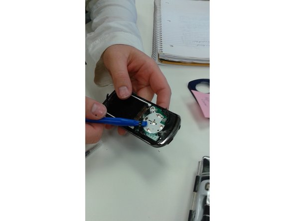

  5. RCA Opal main board replacement: crwdns2935265:05crwdnd2935265:01crwdnd2935265:03crwdne2935265:0 RCA Opal main board replacement: crwdns2935265:05crwdnd2935265:02crwdnd2935265:03crwdne2935265:0 RCA Opal main board replacement: crwdns2935265:05crwdnd2935265:03crwdnd2935265:03crwdne2935265:0
    • Using the prying tool, insert the tip of the tool in between the black plastic and the back cover of the device.
    • Pull upward to pry the black plastic away from the device. It will come off in pieces, but this is okay.
    • There will be thin black plastic surrounding four clear pieces where the buttons used to be located. Remove this as well.

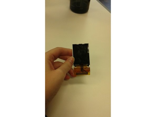

  6. RCA Opal main board replacement: crwdns2935265:06crwdnd2935265:01crwdnd2935265:02crwdne2935265:0 RCA Opal main board replacement: crwdns2935265:06crwdnd2935265:02crwdnd2935265:02crwdne2935265:0
    • Now you should be able to see the main board. A small gold connector strip will connect the screen to the main board.
    • Locate a small white rectangular connector found at the top middle of the main board.
    • Using a prying tool or your fingernail, move the black plastic piece located at the bottom of the white connector to an upward position (toward the screen).
    • This should free the gold connector strip and allow you to remove the screen.
