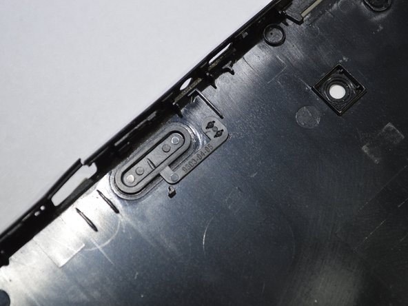

  3. RCA Maven Pro 11 Volume Button Replacement, Volume Button: crwdns2935265:03crwdnd2935265:01crwdnd2935265:02crwdne2935265:0 RCA Maven Pro 11 Volume Button Replacement, Volume Button: crwdns2935265:03crwdnd2935265:02crwdnd2935265:02crwdne2935265:0
    • Locate the volume button on the inside of the cover.
    • Slide a wedge between the cover and the volume button and lightly lift it off.
