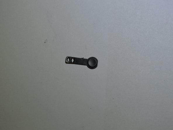

    • Remove all the 8 mm Phillips head screws on the side and back of the device.
  2. RCA Maven Pro 11 Reset Button Replacement: crwdns2935265:02crwdnd2935265:01crwdnd2935265:02crwdne2935265:0 RCA Maven Pro 11 Reset Button Replacement: crwdns2935265:02crwdnd2935265:02crwdnd2935265:02crwdne2935265:0
    • Pry off the cover by sticking a wedge in between the screen and the cover.
    • Be careful with the plastic because it can easily break.
    • Once the cover is partly removed, use your hands to take off the rest of the cover.
  3. RCA Maven Pro 11 Reset Button Replacement, Reset Button: crwdns2935265:03crwdnd2935265:01crwdnd2935265:01crwdne2935265:0
    • Locate the power button on the cover.
  4. RCA Maven Pro 11 Reset Button Replacement: crwdns2935265:04crwdnd2935265:01crwdnd2935265:02crwdne2935265:0 RCA Maven Pro 11 Reset Button Replacement: crwdns2935265:04crwdnd2935265:02crwdnd2935265:02crwdne2935265:0
    • Carefully pull up on the power button. There are two pins holding it in.
    • Remove the power button.
