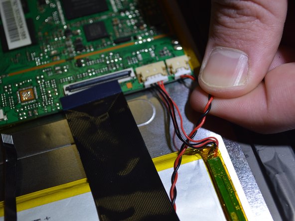

      • Remove all the 8 mm Phillips head screws on the side and back of the device.
    2. RCA Maven Pro 11 Battery Replacement: crwdns2935265:02crwdnd2935265:01crwdnd2935265:02crwdne2935265:0 RCA Maven Pro 11 Battery Replacement: crwdns2935265:02crwdnd2935265:02crwdnd2935265:02crwdne2935265:0
      • Pry off the cover by sticking a wedge in between the screen and the cover.
      • Be careful with the plastic because it can easily break.
      • Once the cover is partly removed, use your hands to take off the rest of the cover.
    1. RCA Maven Pro 11 Battery Replacement, Battery: crwdns2935265:03crwdnd2935265:01crwdnd2935265:02crwdne2935265:0 RCA Maven Pro 11 Battery Replacement, Battery: crwdns2935265:03crwdnd2935265:02crwdnd2935265:02crwdne2935265:0
      • Pull out the pins circled in the picture.
      • These pins can be removed by hand. Just pull on them individually.
    2. RCA Maven Pro 11 Battery Replacement: crwdns2935265:04crwdnd2935265:01crwdnd2935265:01crwdne2935265:0
      • Use the opening tools to peel the battery off of the panel.
      • The glue is located in the corners.
      • Do not bend or puncture the battery.
