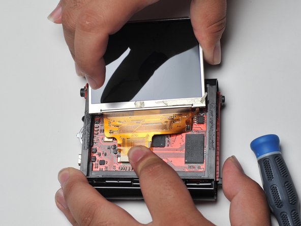

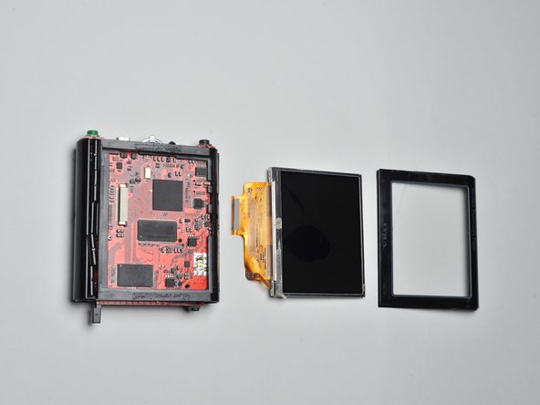

  4. RCA Lyra X2400 flash card reader replacement: crwdns2935265:04crwdnd2935265:01crwdnd2935265:03crwdne2935265:0 RCA Lyra X2400 flash card reader replacement: crwdns2935265:04crwdnd2935265:02crwdnd2935265:03crwdne2935265:0 RCA Lyra X2400 flash card reader replacement: crwdns2935265:04crwdnd2935265:03crwdnd2935265:03crwdne2935265:0
    • Carefully pry up the screen with a plastic opening tool.
    • Disconnect the screen's ribbon cable from the circuit board.
    • Remove the screen.

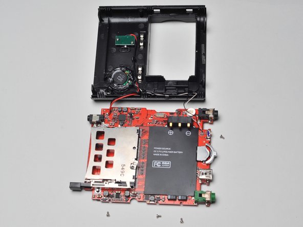

  5. RCA Lyra X2400 flash card reader replacement, Motherboard: crwdns2935265:05crwdnd2935265:01crwdnd2935265:02crwdne2935265:0 RCA Lyra X2400 flash card reader replacement, Motherboard: crwdns2935265:05crwdnd2935265:02crwdnd2935265:02crwdne2935265:0
    • Open the case of the Lyra.
    • Remove the four screws that secure the motherboard to the frame of the Lyra X2400.

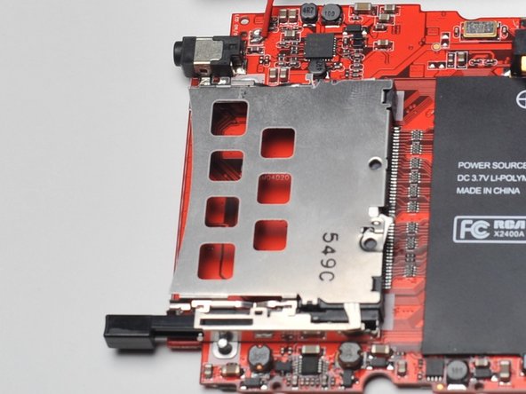

  6. RCA Lyra X2400 flash card reader replacement, Compact Flash Card: crwdns2935265:06crwdnd2935265:01crwdnd2935265:02crwdne2935265:0 RCA Lyra X2400 flash card reader replacement, Compact Flash Card: crwdns2935265:06crwdnd2935265:02crwdnd2935265:02crwdne2935265:0
    • Locate the compact flash card slot on the logic board. For assistance on locating this component look at the picture to the left.
    • Use soldering/desoldering tools to remove the compact flash card.
    • Replace compact flash card and use soldering tools to complete the replacement.
