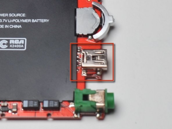

  5. RCA Lyra X2400 USB port replacement, USB in/out: crwdns2935265:05crwdnd2935265:01crwdnd2935265:02crwdne2935265:0 RCA Lyra X2400 USB port replacement, USB in/out: crwdns2935265:05crwdnd2935265:02crwdnd2935265:02crwdne2935265:0
    • Locate the USB in/out component on your Lyra X2400. If you are having difficulty locating this component the picture to the left will show you where it is located.
    • Start using solder/desolder tools to remove the USB in/out.
    • Once removed replace it with the new working USB in/out.
    • Use the soldering tools to reattach the component back to the main logic board.
