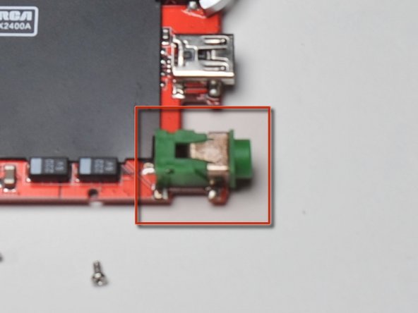

  5. RCA Lyra X2400 DC Power Adaptor Replacement, Motherboard: crwdns2935265:05crwdnd2935265:01crwdnd2935265:02crwdne2935265:0 RCA Lyra X2400 DC Power Adaptor Replacement, Motherboard: crwdns2935265:05crwdnd2935265:02crwdnd2935265:02crwdne2935265:0
    • Open the case of the Lyra.
    • Remove the four screws that secure the motherboard to the frame of the Lyra X2400.
  6. RCA Lyra X2400 DC Power Adaptor Replacement, DC Power Adaptor: crwdns2935265:06crwdnd2935265:01crwdnd2935265:02crwdne2935265:0 RCA Lyra X2400 DC Power Adaptor Replacement, DC Power Adaptor: crwdns2935265:06crwdnd2935265:02crwdnd2935265:02crwdne2935265:0
    • Locate the DC power adaptor component on your Lyra X2400. If you are having difficulty locating this component the picture to the left will show you where it is located.
    • Start using solder/desolder tools to remove the DC power adaptor.
    • If you need information on soldering, check out this guide.
    • Once removed replace it with the new working DC power adaptor.
    • Use the soldering tools to reattach the component back to the main logic board.
