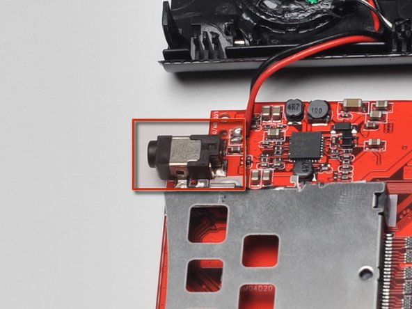

  5. RCA Lyra X2400 Audio Jack Replacement, Audio Jack: crwdns2935265:05crwdnd2935265:01crwdnd2935265:02crwdne2935265:0 RCA Lyra X2400 Audio Jack Replacement, Audio Jack: crwdns2935265:05crwdnd2935265:02crwdnd2935265:02crwdne2935265:0
    • Locate the audio jack on the Lyra X2400. If you have difficulty locating this component look at the picture to the left.
    • Start using the solder/desolder tools to remove this component.
    • Once removed replace the old audio jack with a new audio jack.
    • Use soldering tools to reattach this component back to the main logic board.
