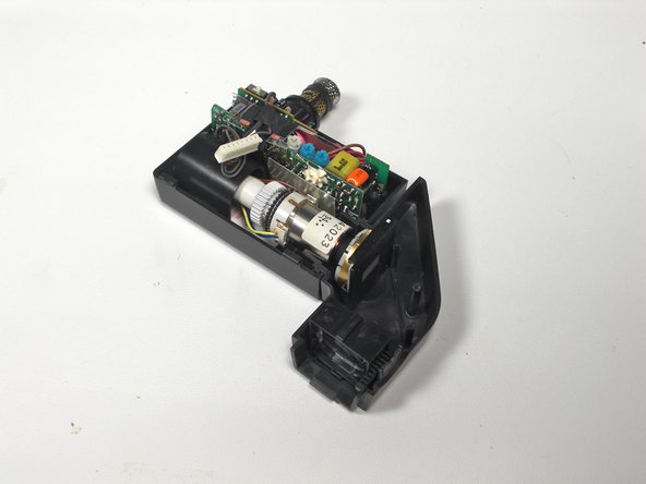

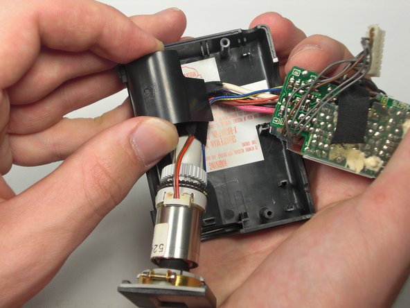

  4. RCA CC310 Viewfinder Replacement: crwdns2935265:04crwdnd2935265:01crwdnd2935265:01crwdne2935265:0
    • Flip back the viewfinder access tab.
    • Unscrew the 7.0mm ph #0 screw next to the mirror.

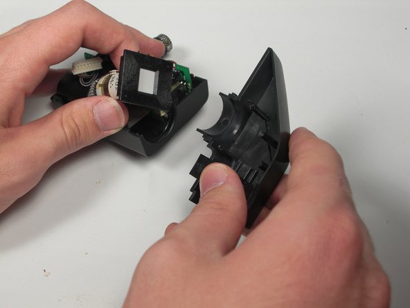

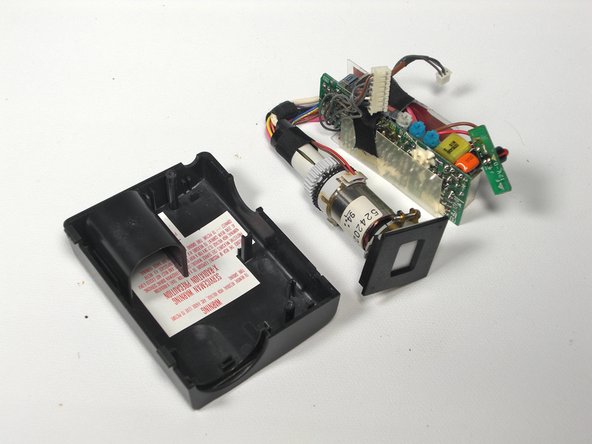

  5. RCA CC310 Viewfinder Replacement: crwdns2935265:05crwdnd2935265:01crwdnd2935265:03crwdne2935265:0 RCA CC310 Viewfinder Replacement: crwdns2935265:05crwdnd2935265:02crwdnd2935265:03crwdne2935265:0 RCA CC310 Viewfinder Replacement: crwdns2935265:05crwdnd2935265:03crwdnd2935265:03crwdne2935265:0
    • Lift off both sides of the plastic assembly.
    • When reassembling, if the housing doesn't connect properly, try turning the focus wheel.

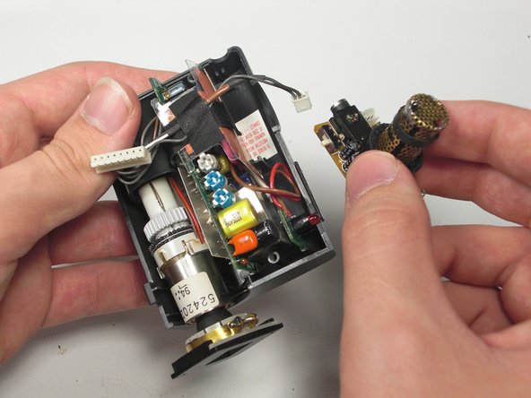

  6. RCA CC310 Viewfinder Replacement: crwdns2935265:06crwdnd2935265:01crwdnd2935265:02crwdne2935265:0 RCA CC310 Viewfinder Replacement: crwdns2935265:06crwdnd2935265:02crwdnd2935265:02crwdne2935265:0
    • Lift the microphone circuit board straight up.
    • Unclip the cable connected to the circuit board.

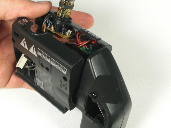

  7. RCA CC310 Viewfinder Replacement: crwdns2935265:07crwdnd2935265:01crwdnd2935265:03crwdne2935265:0 RCA CC310 Viewfinder Replacement: crwdns2935265:07crwdnd2935265:02crwdnd2935265:03crwdne2935265:0 RCA CC310 Viewfinder Replacement: crwdns2935265:07crwdnd2935265:03crwdnd2935265:03crwdne2935265:0
    • Lift plastic housing and guide the wires from underneath.
    • Lift out the entire circuit board and viewfinder.
    • Replace entire circuit board and viewfinder assembly.
