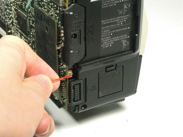

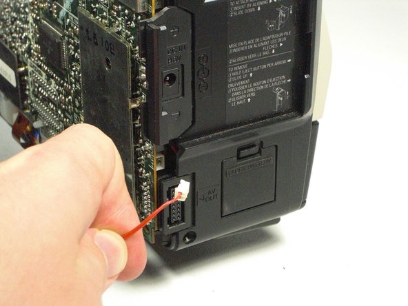

    • Pull the left panel away from the rest of the camcorder.
    • Unplug the red speaker cable located at the rear of the device.
    • Be careful to not pull too hard. The speaker cable is still connected to the panel and it can rip.
  5. RCA CC310 Onboard Speaker Replacement, Onboard Speaker: crwdns2935265:05crwdnd2935265:01crwdnd2935265:02crwdne2935265:0 RCA CC310 Onboard Speaker Replacement, Onboard Speaker: crwdns2935265:05crwdnd2935265:02crwdnd2935265:02crwdne2935265:0
    • Unplug the red cable connecting the speaker to the motherboard.

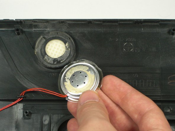

    • Locate the speaker on the removed panel. Find the groove on the top left side of the speaker.
    • Pry the plastic up with a spudger until the glue breaks and the speaker is detached.
  7. RCA CC310 Onboard Speaker Replacement: crwdns2935265:07crwdnd2935265:01crwdnd2935265:01crwdne2935265:0
    • Break the plastic pieces holding the cable to the panel.
    • Glue the new cables, with a hot glue gun, back to the panel after replacing the speaker.
  8. RCA CC310 Onboard Speaker Replacement: crwdns2935265:08crwdnd2935265:01crwdnd2935265:03crwdne2935265:0 RCA CC310 Onboard Speaker Replacement: crwdns2935265:08crwdnd2935265:02crwdnd2935265:03crwdne2935265:0 RCA CC310 Onboard Speaker Replacement: crwdns2935265:08crwdnd2935265:03crwdnd2935265:03crwdne2935265:0
    • Glue the new speaker to the panel.
    • Plug the cable back into the motherboard.
