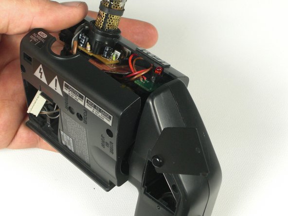

    • Lift the metal flap and slide the viewfinder off to the right.
  2. RCA CC310 Onboard Microphone Replacement: crwdns2935265:02crwdnd2935265:01crwdnd2935265:03crwdne2935265:0 RCA CC310 Onboard Microphone Replacement: crwdns2935265:02crwdnd2935265:02crwdnd2935265:03crwdne2935265:0 RCA CC310 Onboard Microphone Replacement: crwdns2935265:02crwdnd2935265:03crwdnd2935265:03crwdne2935265:0
    • Unscrew the 7.0mm ph#0 screw on the underside where the cable connects.
    • Lift the plastic where the cable is connected to the viewfinder.
    • Disconnect the cable inside by pulling it apart.
  3. RCA CC310 Onboard Microphone Replacement: crwdns2935265:03crwdnd2935265:01crwdnd2935265:02crwdne2935265:0 RCA CC310 Onboard Microphone Replacement: crwdns2935265:03crwdnd2935265:02crwdnd2935265:02crwdne2935265:0
    • Unscrew the two 7mm ph#0 screws on the underside of the viewfinder assembly.
    • Lift the viewfinder plastic assembly up.

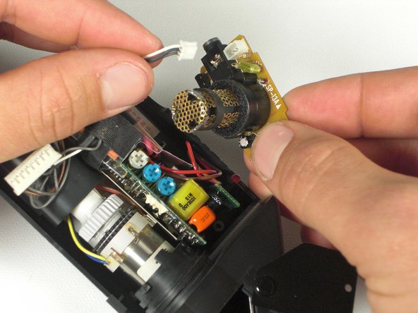

  4. RCA CC310 Onboard Microphone Replacement: crwdns2935265:04crwdnd2935265:01crwdnd2935265:02crwdne2935265:0 RCA CC310 Onboard Microphone Replacement: crwdns2935265:04crwdnd2935265:02crwdnd2935265:02crwdne2935265:0
    • Lift the microphone circuit board straight up.
    • Unclip the cable connected to the circuit board.
  5. RCA CC310 Onboard Microphone Replacement: crwdns2935265:05crwdnd2935265:01crwdnd2935265:01crwdne2935265:0
    • Turn the microphone circuit board over.
    • Unscrew the two Ph#0 screws holding the plastic housing on the circuit board.
  6. RCA CC310 Onboard Microphone Replacement: crwdns2935265:06crwdnd2935265:01crwdnd2935265:01crwdne2935265:0
    • Desolder the metal protective housing using a soldering iron.
    • Desolder the microphone and replace it.
