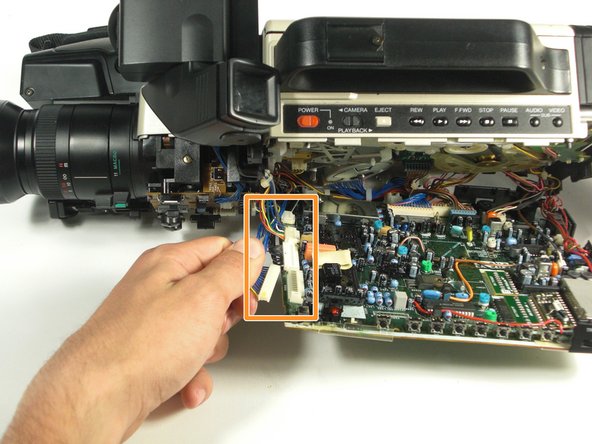

  5. RCA CC310 Main Motherboard Replacement, Main Motherboard: crwdns2935265:05crwdnd2935265:01crwdnd2935265:02crwdne2935265:0 RCA CC310 Main Motherboard Replacement, Main Motherboard: crwdns2935265:05crwdnd2935265:02crwdnd2935265:02crwdne2935265:0
    • Pull back the plastic tabs along the edges of the motherboard.
    • Disconnect all the cables along the left side of the motherboard.
  6. RCA CC310 Main Motherboard Replacement: crwdns2935265:06crwdnd2935265:01crwdnd2935265:02crwdne2935265:0 RCA CC310 Main Motherboard Replacement: crwdns2935265:06crwdnd2935265:02crwdnd2935265:02crwdne2935265:0
    • Disconnect all cables along the bottom of the motherboard.
    • Pull the motherboard away from the camcorder.

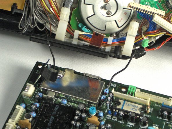

  7. RCA CC310 Main Motherboard Replacement: crwdns2935265:07crwdnd2935265:01crwdnd2935265:01crwdne2935265:0
    • Desolder the two black wires holding the motherboard to the camcorder using a soldering iron.
