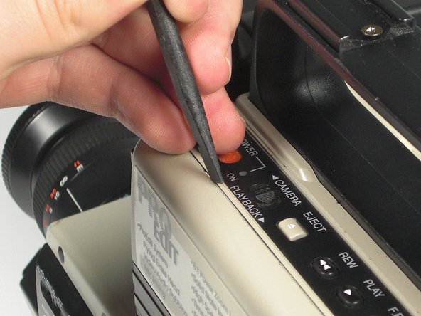

  3. RCA CC310 Effect Button Circuit Board Replacement: crwdns2935265:03crwdnd2935265:01crwdnd2935265:02crwdne2935265:0 RCA CC310 Effect Button Circuit Board Replacement: crwdns2935265:03crwdnd2935265:02crwdnd2935265:02crwdne2935265:0
    • Pry along the seam on the top side near the buttons with a spudger.

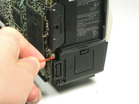

  4. RCA CC310 Effect Button Circuit Board Replacement: crwdns2935265:04crwdnd2935265:01crwdnd2935265:02crwdne2935265:0 RCA CC310 Effect Button Circuit Board Replacement: crwdns2935265:04crwdnd2935265:02crwdnd2935265:02crwdne2935265:0
    • Pull the left panel away from the rest of the camcorder.
    • Unplug the red speaker cable located at the rear of the device.
    • Be careful to not pull too hard. The speaker cable is still connected to the panel and it can rip.

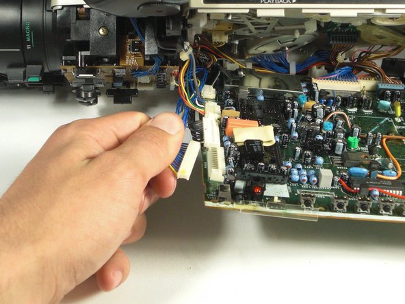

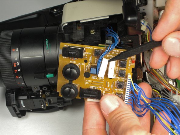

  5. RCA CC310 Effect Button Circuit Board Replacement, Effect Button Circuit Board: crwdns2935265:05crwdnd2935265:01crwdnd2935265:02crwdne2935265:0 RCA CC310 Effect Button Circuit Board Replacement, Effect Button Circuit Board: crwdns2935265:05crwdnd2935265:02crwdnd2935265:02crwdne2935265:0
    • Unplug the two cables on the bottom of the effect button circuit board.
    • Unplug the cable at the top left side of the motherboard.

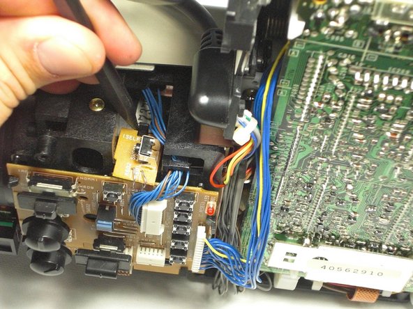

  6. RCA CC310 Effect Button Circuit Board Replacement: crwdns2935265:06crwdnd2935265:01crwdnd2935265:03crwdne2935265:0 RCA CC310 Effect Button Circuit Board Replacement: crwdns2935265:06crwdnd2935265:02crwdnd2935265:03crwdne2935265:0 RCA CC310 Effect Button Circuit Board Replacement: crwdns2935265:06crwdnd2935265:03crwdnd2935265:03crwdne2935265:0
    • Pull the plastic tabs away from the circuit board.
    • Pull the board away from the camcorder.
    • Use a spudger to help push the mini-circuit board away from the camcorder at the same time.
    • Unplug the cable in the middle of the effects board.
