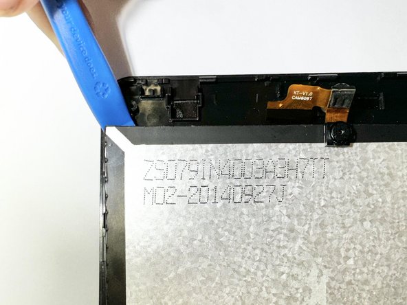

      • Insert an iFixit opening tool into the gap between the tablet and back panel.
      • Using a combination of iFixit opening tools and iFixit opening picks, pry the tablet upward around its perimeter to release it from the plastic rear case.
      • If inserted too far, an opening pick can damage your device. It is helpful to mark the edge with an opening pick, or opening tool at a depth that will not damage the inner contents of the tablet.

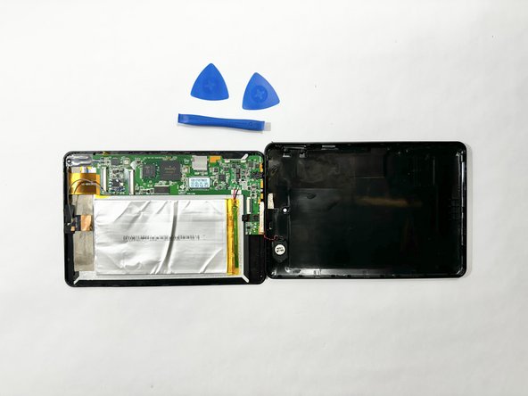

    3. RCA 8 Apollo Screen Replacement: crwdns2935265:03crwdnd2935265:01crwdnd2935265:02crwdne2935265:0 RCA 8 Apollo Screen Replacement: crwdns2935265:03crwdnd2935265:02crwdnd2935265:02crwdne2935265:0
      • Disconnect the red and black speaker wires from the tablet.
      • The front and back of the tablet will be disconnected.

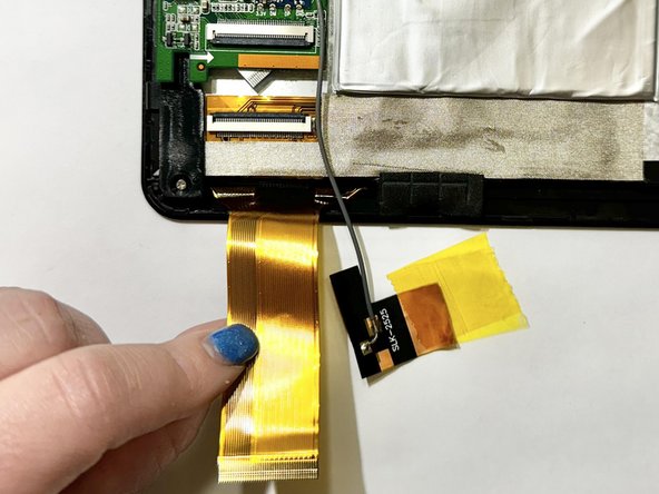

    1. RCA 8 Apollo Screen Replacement, Display Assembly: crwdns2935265:04crwdnd2935265:01crwdnd2935265:03crwdne2935265:0 RCA 8 Apollo Screen Replacement, Display Assembly: crwdns2935265:04crwdnd2935265:02crwdnd2935265:03crwdne2935265:0 RCA 8 Apollo Screen Replacement, Display Assembly: crwdns2935265:04crwdnd2935265:03crwdnd2935265:03crwdne2935265:0

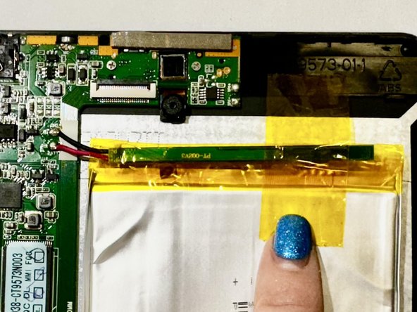

      • Release the gold and black tab from the battery that's attached to a gray wire. The gold tab is held down by an adhesive; pull it until the adhesive releases.
      • Remove the yellow tape that is around the battery.
      • Unlock the ZIF socket and detach the display data interconnect cable from the front panel assembly.
      • If the connector is misaligned, the pins can bend, causing permanent damage.

    3. RCA 8 Apollo Screen Replacement: crwdns2935265:06crwdnd2935265:01crwdnd2935265:01crwdne2935265:0
      • Remove the battery and motherboard together from the tablet.
      • If the tablet needs a battery replacement, disconnect the battery and replace it with a new one.
      • The battery might be glued down; you will just need to slowly remove the battery as the adhesive releases.

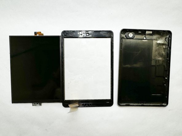

    1. RCA 8 Apollo Screen Replacement, Screen: crwdns2935265:07crwdnd2935265:01crwdnd2935265:03crwdne2935265:0 RCA 8 Apollo Screen Replacement, Screen: crwdns2935265:07crwdnd2935265:02crwdnd2935265:03crwdne2935265:0 RCA 8 Apollo Screen Replacement, Screen: crwdns2935265:07crwdnd2935265:03crwdnd2935265:03crwdne2935265:0
      • Remove the screw from the bottom left of the tablet.
      • Place an opening tool under the screen.
      • Pry up the screen and it will unclip from the clips holding the screen down.
      • Avoid using too much force to prevent the glass from breaking.
